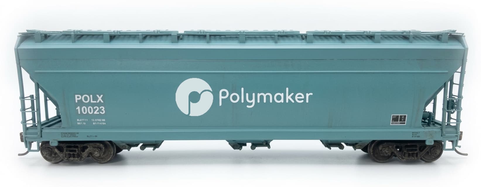

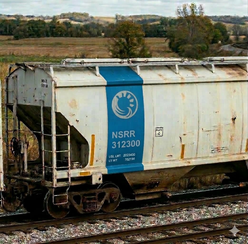

I’ve been using AI to try out paint schemes.
Just got the joke… Polymaker being a 3d printing filament source… :grinning:

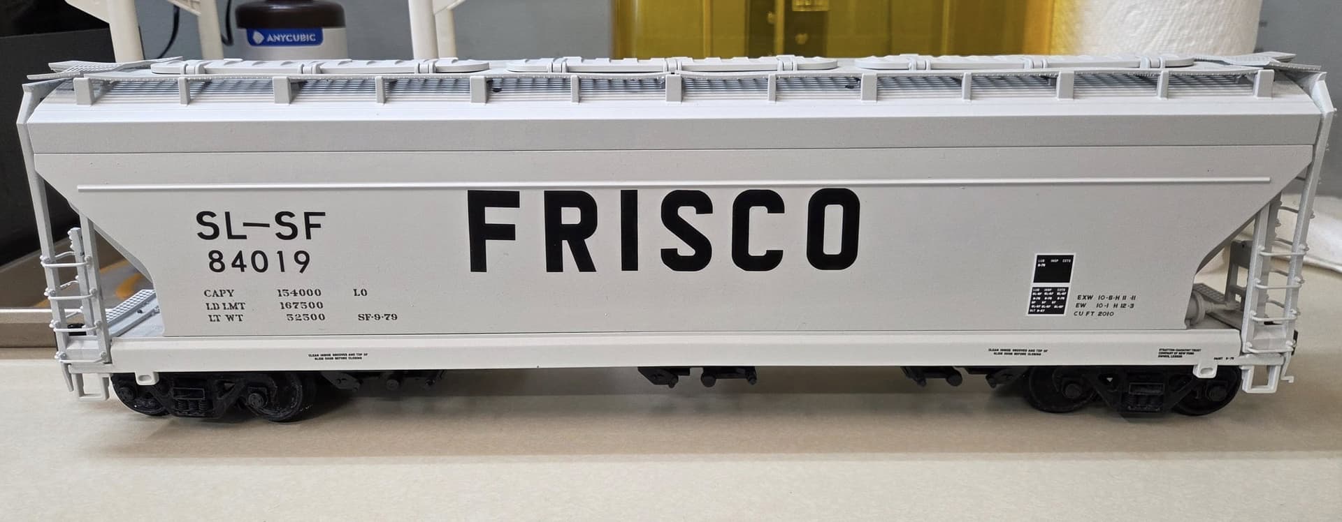

Your model shot sure looks proferssionally done. Did you set that up and have AI do only the paint & lettering over it? Or did it create that shot from scratch, or somewhere in between?
It’s someone else’s custom painted Frisco hopper. Here is the original.
I uploaded it to Gemini along with the polymaker logo.

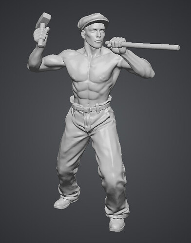

I’m looking into using AI for generating 3d-printable meshes of miners and mules, and am very impressed so far.

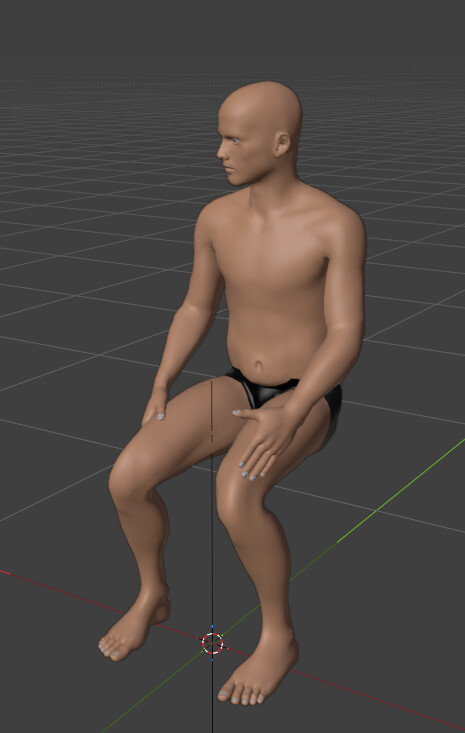

Last weekend I worked with Blender (free) to make a posable miner figure. You start with a human shape and modify poses & etc., but clothing is very difficult. Actually it’s all very tough for me, since I have no experience with this sort of free-form modeling. It took almost an entire day for me to learn how to “rig” the figure with a skeleton and do a simple pose. I figure I’d have to manually sculpt clothing onto it.
There are paid products like HumGen3D that can create and clothe figures, and then you pose them in Blender. But now, I’m heading in a different direction. I heard about Meshy at work, and also Tripo, and they cost around $20/month. For the number of figures I need, it’s worth it if it works.

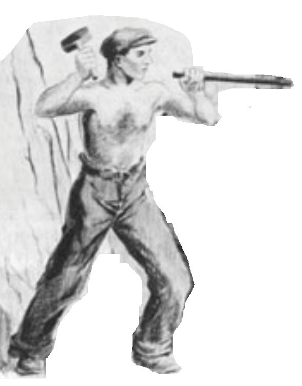

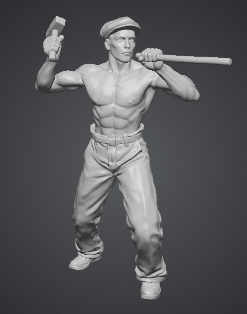

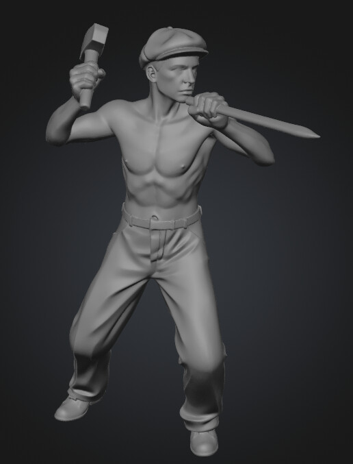

Here’s an experiment in Meshy. All I did was shove this old drawing in, without textual instructions or anything.
Here’s what it came up with, in about 45 seconds:
I did the same in Tripo:
These are both “watertight” for printing. I haven’t subscribed yet, but when you do, you can scale and download the figure. Both also seem to have a direct bridge to Blender, which would allow further posing.

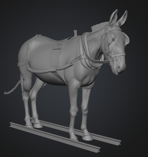

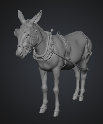

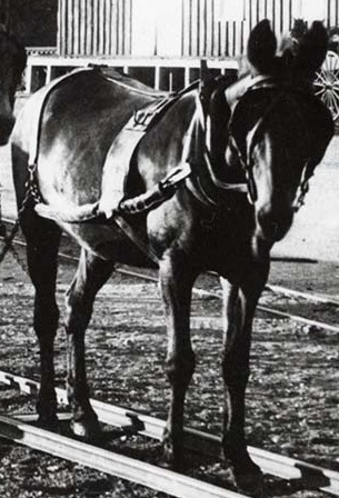

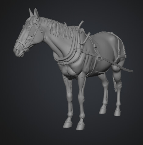

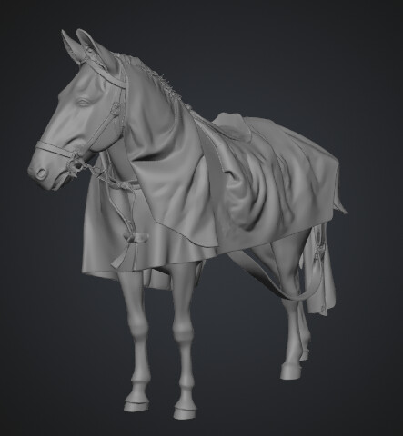

Here’s a few more examples (using Meshy) with mules. Again, all just with one photo.
cropped - Mule-Team-Sutro-NV-43667 - Copy
cropped - Sutro mules, from Nevada Ghost Towns & Beyond - Copy
The AI gets confused here and there, such as with the blanket in the last one. And even though the model is watertight, that doesn’t mean all the harness parts will print. So either more pre-processing in Blender, or post-processing with Mr. Dremel, will be in order.
For about 30-45 seconds per model, from only one photo, I’m pretty amazed. If the software will pre-rig the figure and export to blender for different poses, that’ll be awesome.

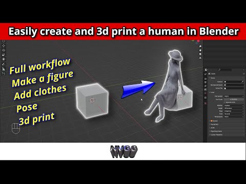

A couple of videos. Both guys have lots more, covering various aspects in detail.
This one is how to make a printable figure in Blender. Not AI, but educational.

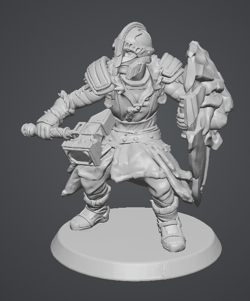

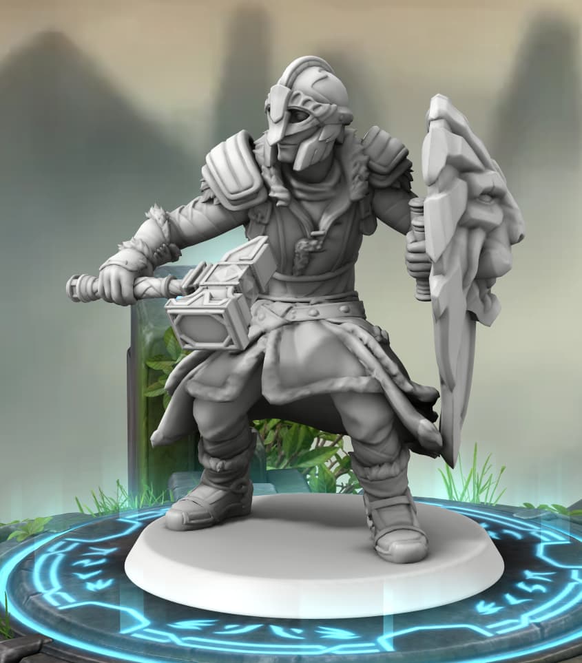

There’s a really cool website for making tabletop gaming minis. You can use it to make some generic looking people as well.
https://www.heroforge.com

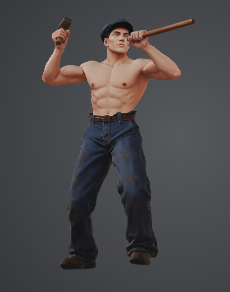

Very cool. It took about 20 seconds to “make” this:
For grins, I pasted this flat image into Tripo to see what it would do:
Pretty amazing stuff!

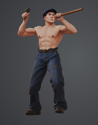

I signed up for a year of Tripo, and I tried to rig and pose it differently. I guess I need to read some tutorials because I totally failed. It did export to Blender, and allowed re-posing there, but not easily.
Posing will have to come at a later day.
Tripo did colorize the figure nicely.

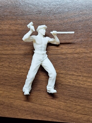

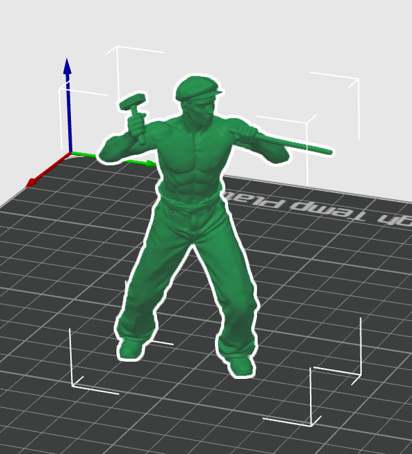

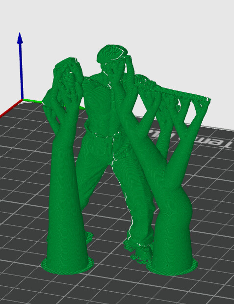

Might be a good opportunity to print in 2 colors, blue and flesh. Another learning curve for another day. For now, I was able to export my miner to STL and open it in the Bambu slicer. I scaled it up there.
Bambu decided on the infill and generated the supports.
Saved that to a stick, and am doing a first print now…
I’m still amazed that Tripo / AI made this 3d model from a hacked, single-view, and not great quality sketch.
