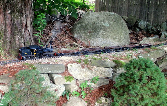

My 3 cylinder shay was able to take 10% grades if I allowed the pressure to run up over 40psi. Most of my line was 4%, but the first stretch of 10-15ft was a lot steeper. The loco was able to pull 6 loaded LGB disconnects with plastic wheels, or 3 Spectrum flats with metal wheels without much slipping, even after many runs. This step section, of course was mostly straight with a couple of very gentle custom bent curves on each end.
The engine used a lot of steam, but I found I could throttle back the gas shortly after the heavy grade to avoid releasing the safety when the terrain settled out. I also had a method for adding water systematically. Like many loggin RRs, I ran the train point-to-point, push-pull, so I was always stopping at the top of the hill for water (and presumably to load or unload logs) and again at the bottom of the hill to raise pressure and change direction for the climb ahead.
Nice pictures, Jeff. What are the rough-looking wooden things I can see there? :wink:

Many folks have made note of my less-than-hefty looking log loads…(they are very lightweight for the big hill). I suppose when you see the 1:1 lumber looming over the scene it becomes clear I would need a much bigger train!
