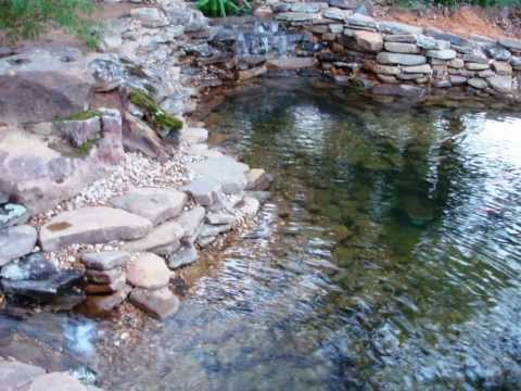

Step 5: Build a Fish Pond
Based on Eric Muellerâs Triple O Railroad
What Youâll Need:
- A pond liner or preformed pond tub
- Aquarium-safe silicone and sealants
- Optional filtration system
- Shade solution (cloth or plants)
- Livestock and aquatic plants
Steps:
- Excavate Carefully: Ensure level base; provide depth and slope for fish safety.
- Install Liner or Tub: Pad base with sand or underlayment; smooth out wrinkles.
- Create Edges and Beaches: Use flat rocks, sand, and sealant for realism and safety.
- Add Plants and Decorations: Floaters like hyacinths help control heat and algae.
- Cycle the Pond Before Adding Fish: Let water stabilize for several days.
- Choose Hardy Fish: Find out what will survive in your environment. Guppies, mollies, or white cloud minnows are great for beginners, but, unless you live someplace warm year round. you will need to bring them inside in the fall thru spring
Pro Tip: At 1:24 scale, a guppy becomes a trout! Choose fish that match your railroadâs visual scale and story.
