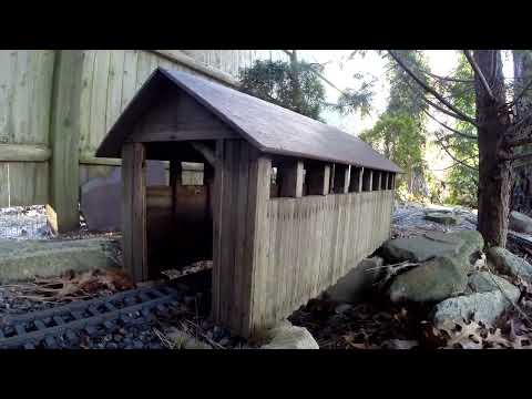

Here is a video that highlights my custom made Portals, Trestles and Bridges plus a retaining wall or 3. Maybe some of you newbies will get some ideas and be inspired to build something similar for your RR?
Happy RRing!
Happy RRing!
Beautiful work, Todd!
Question about your long tunnels, do you put hatches in for derailments / etc.?
Thanks Cliff. The shorter tunnels are 2-6’ long so no need for a hatch. Pinch Point tunnel which is 15’ long has 2 hatches just in case. The corrugated pipe one on the mountain has its own route and does not see a lot of trains due to the tighter 5’ diameter curved track up there. The tunnel is about 8’ long and it doesn’t have a hatch. So far so good in there when it comes to derailments. I guess the Gremlins haven’t figured this out yet.
