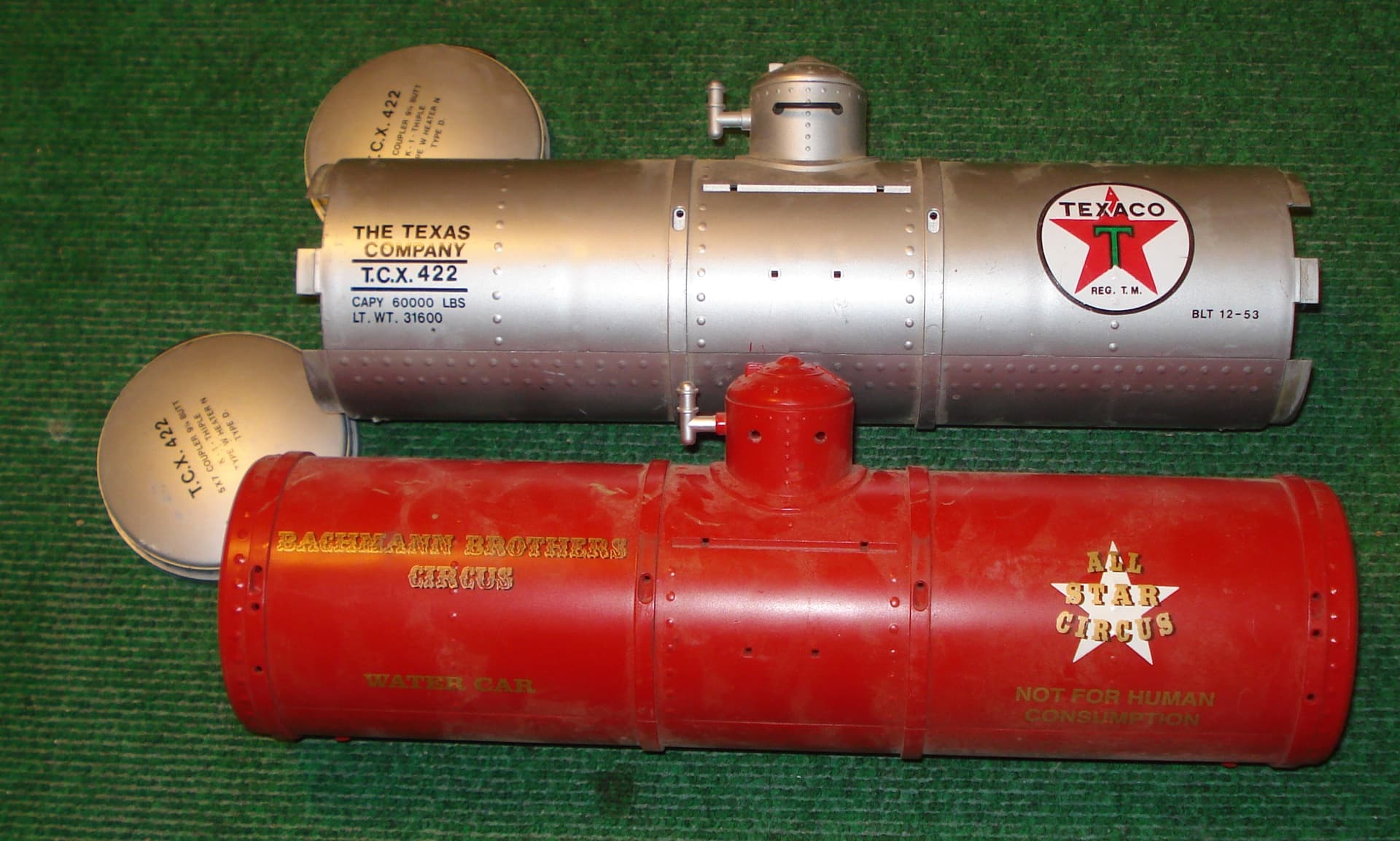

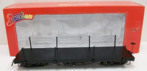

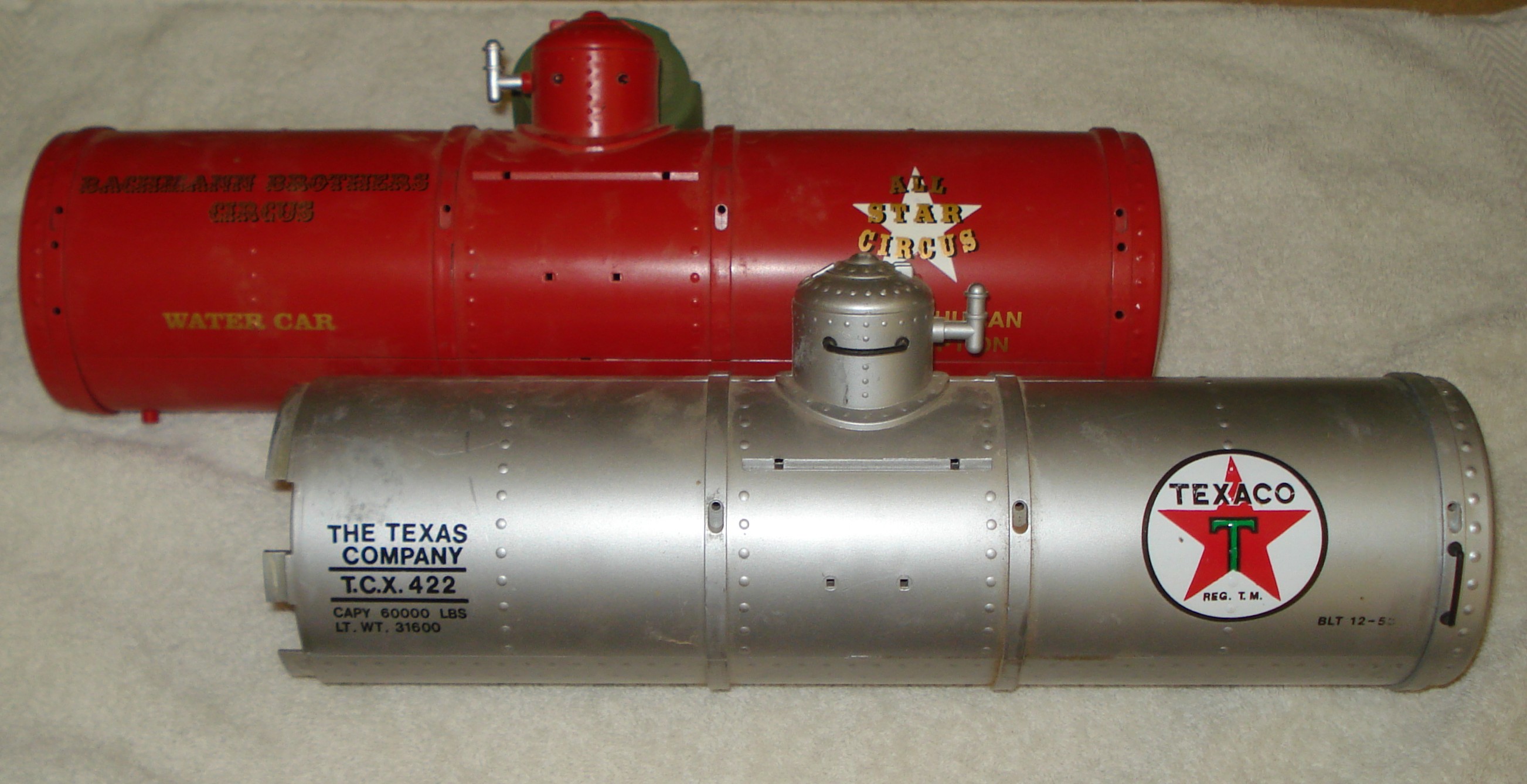

Here are the Bmann parts. Two Big Hauler tanks and a spectrum flatcar. Since I want it to look like a shop built item the different size tanks would set it apart from both my accucraft tankers and Spectrum framed car fleets.
two 7

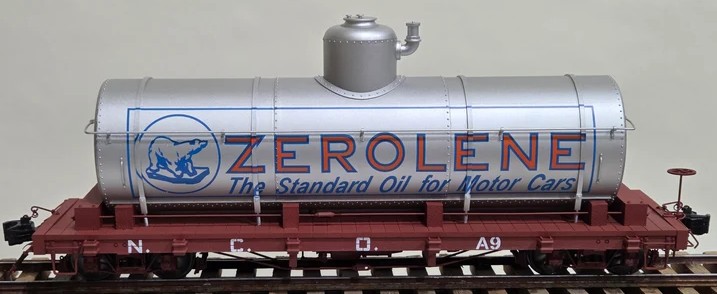

I also have parts from Accucraft. Two tanks and a flat. This has the advantage of the chocks and tension rods already installed.

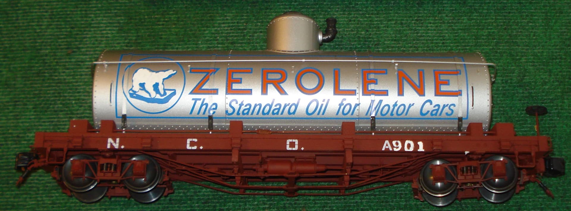

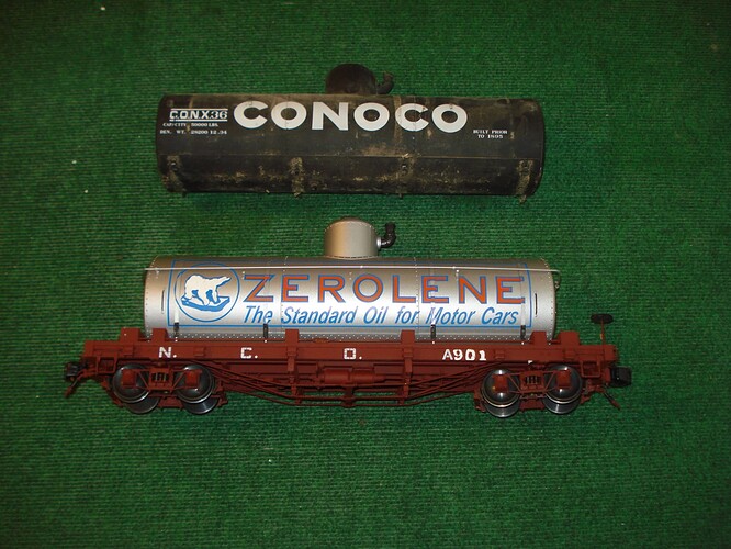

The Zerolene was picked up on E-bay for $50. As much as I would like to have a Zerolene for collection purposes this one is crapped up with someone’s attempt at a repaint. Including the bear logo and car number. I think it is craft paint and looks like something a kid would do.

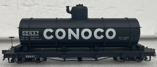

The Conoco was given to me by a friend in Albuquerque and could be brought back to life with a tankectomy. It is also a car I would like to have for my collection. This would add another item to my list of projects and it would still be kind of a kit bash since I can’t fix the flimsy handrails to Accucraft style.

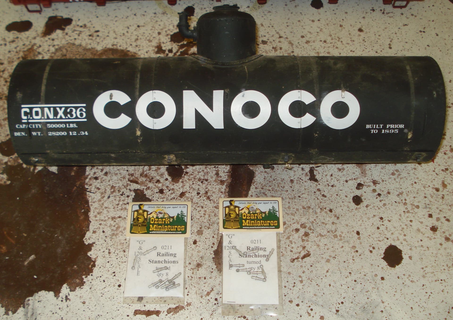

My first focus is to rebuild the Conoco car. I don’t have one and this seems like an easy thing. I removed the Zerolene tank and sized up the job.
The car itself looks like it will be the easiest part.

Remove the original broken handrail stanchions
Replace stanchions and handrail

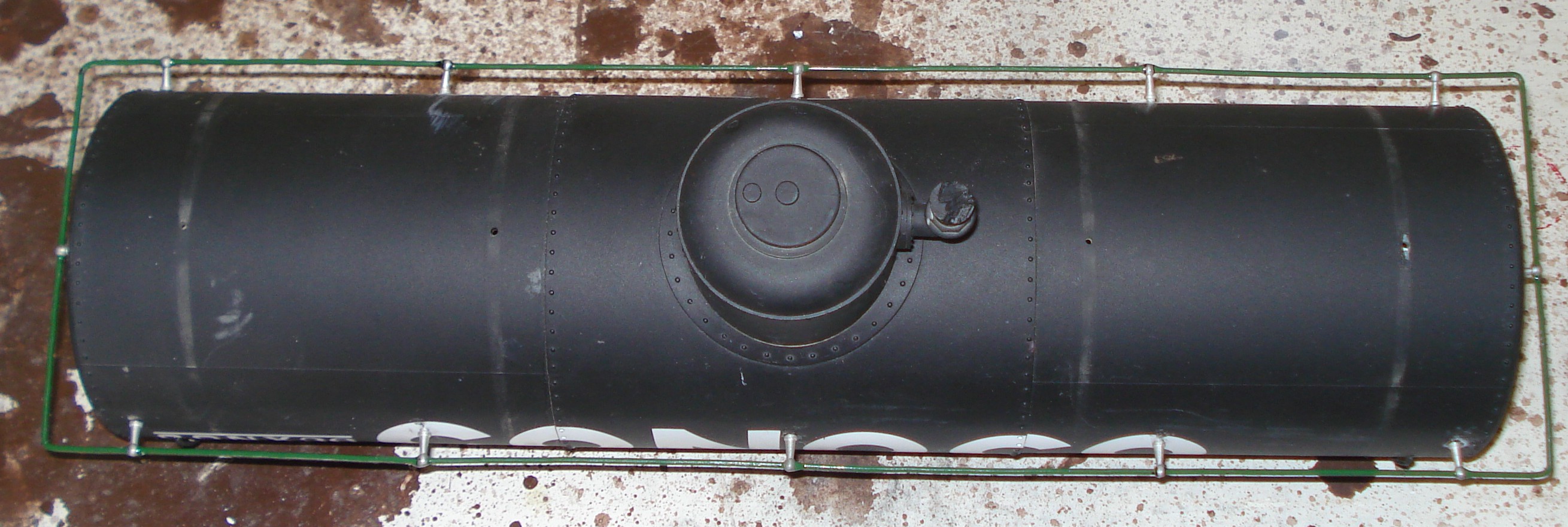

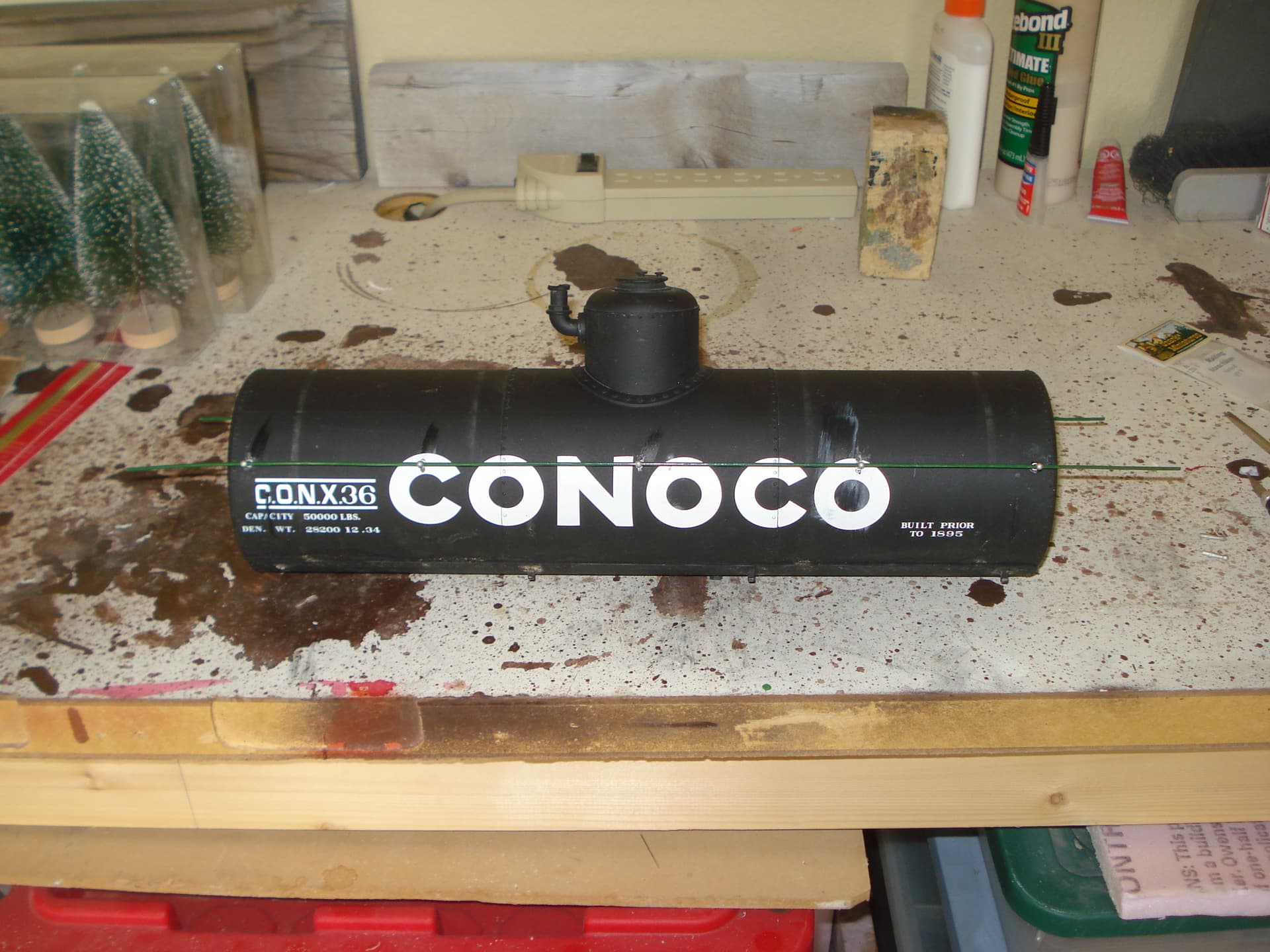

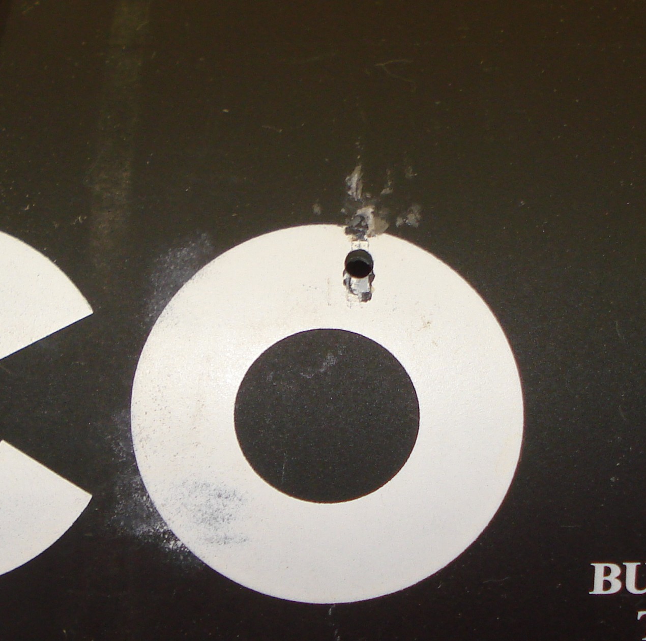

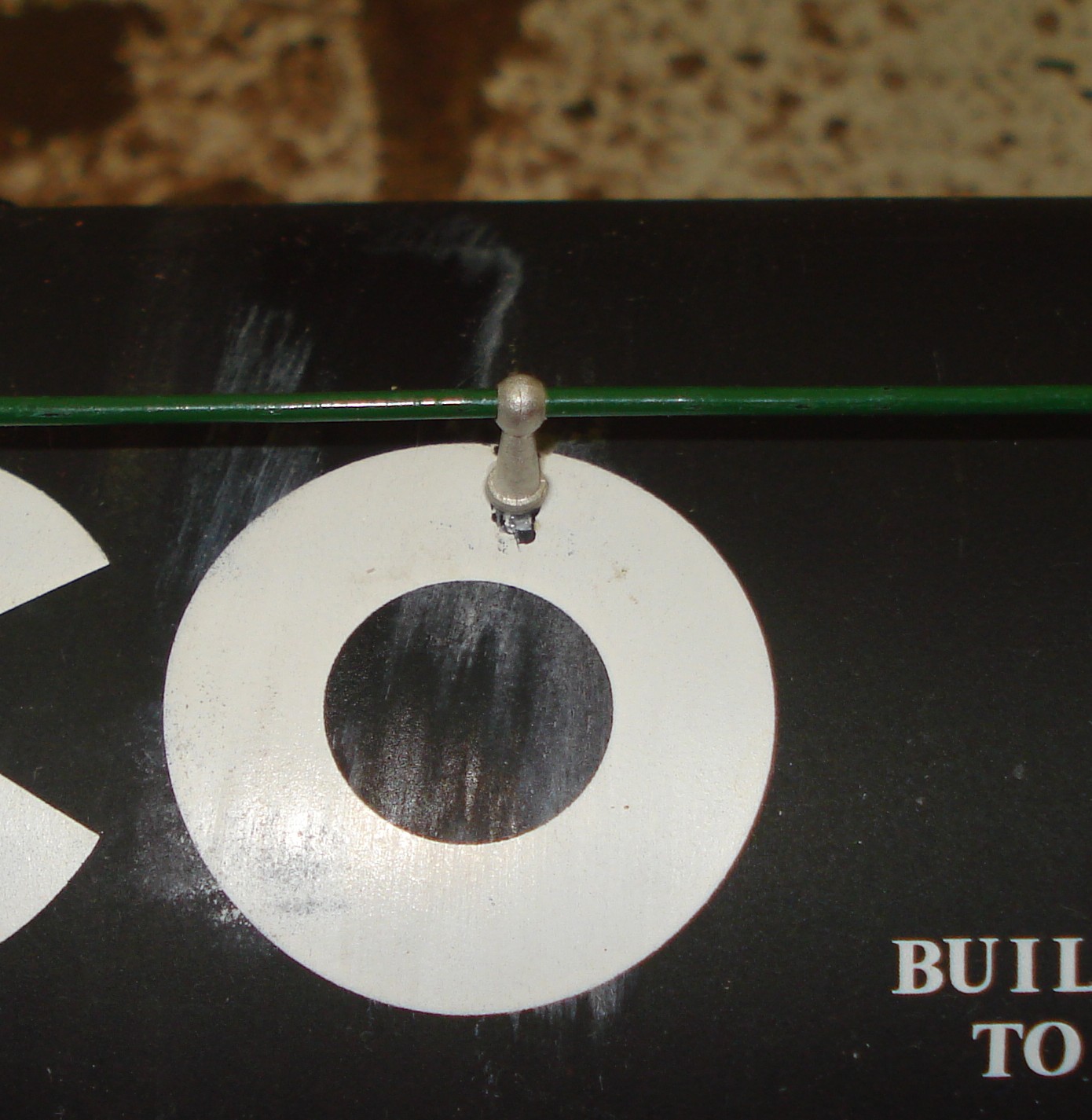

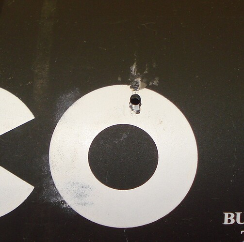

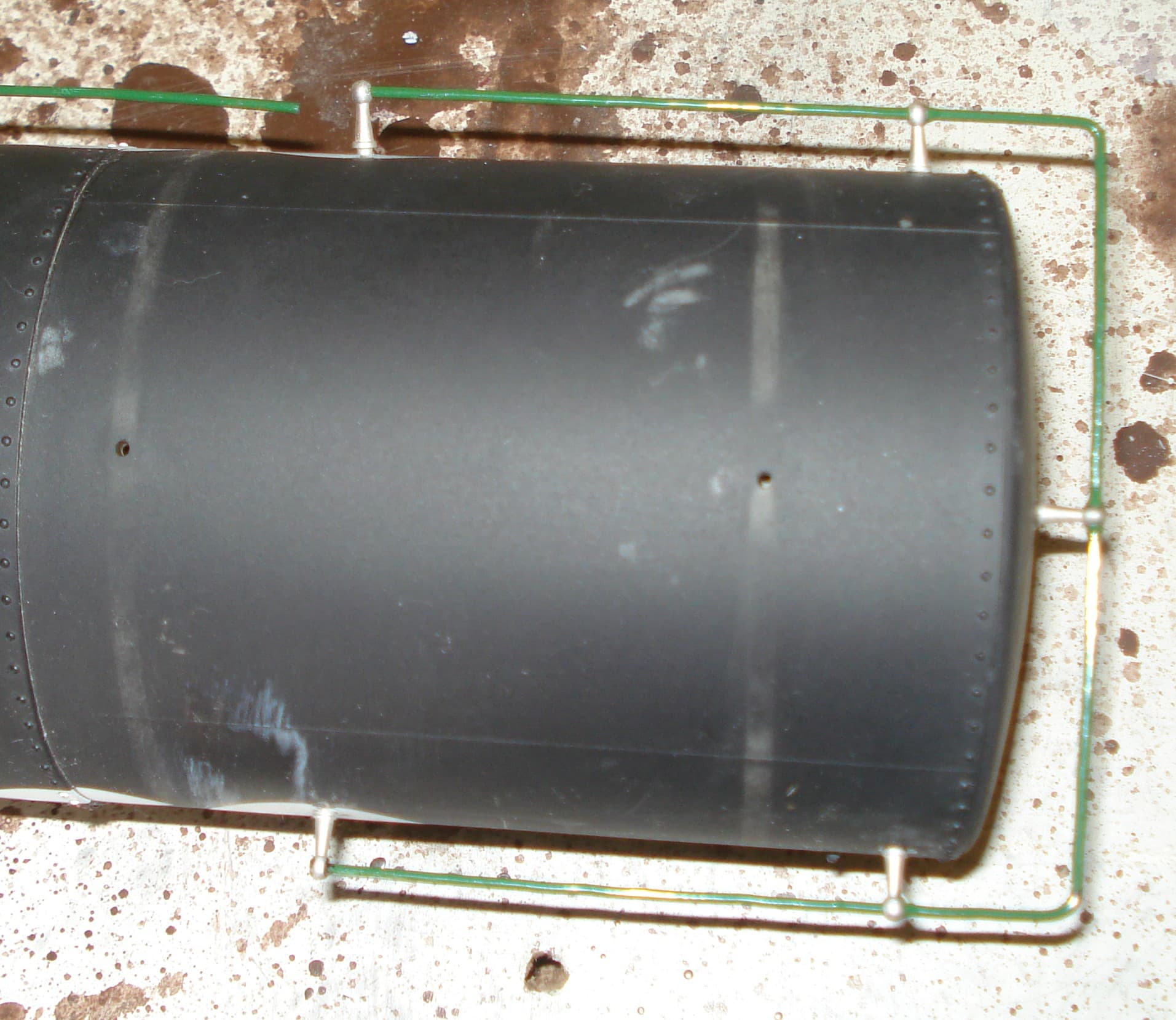

First I removed the old stanchion pieces. These are thin plastic and surprisingly poorly done for Accucraft. They are glued in just above the alignment pin, so had to be shaved off with an Exacto knife. A little tricky since I had to preserve the paint job. Despite my best efforts some touch up will be required.

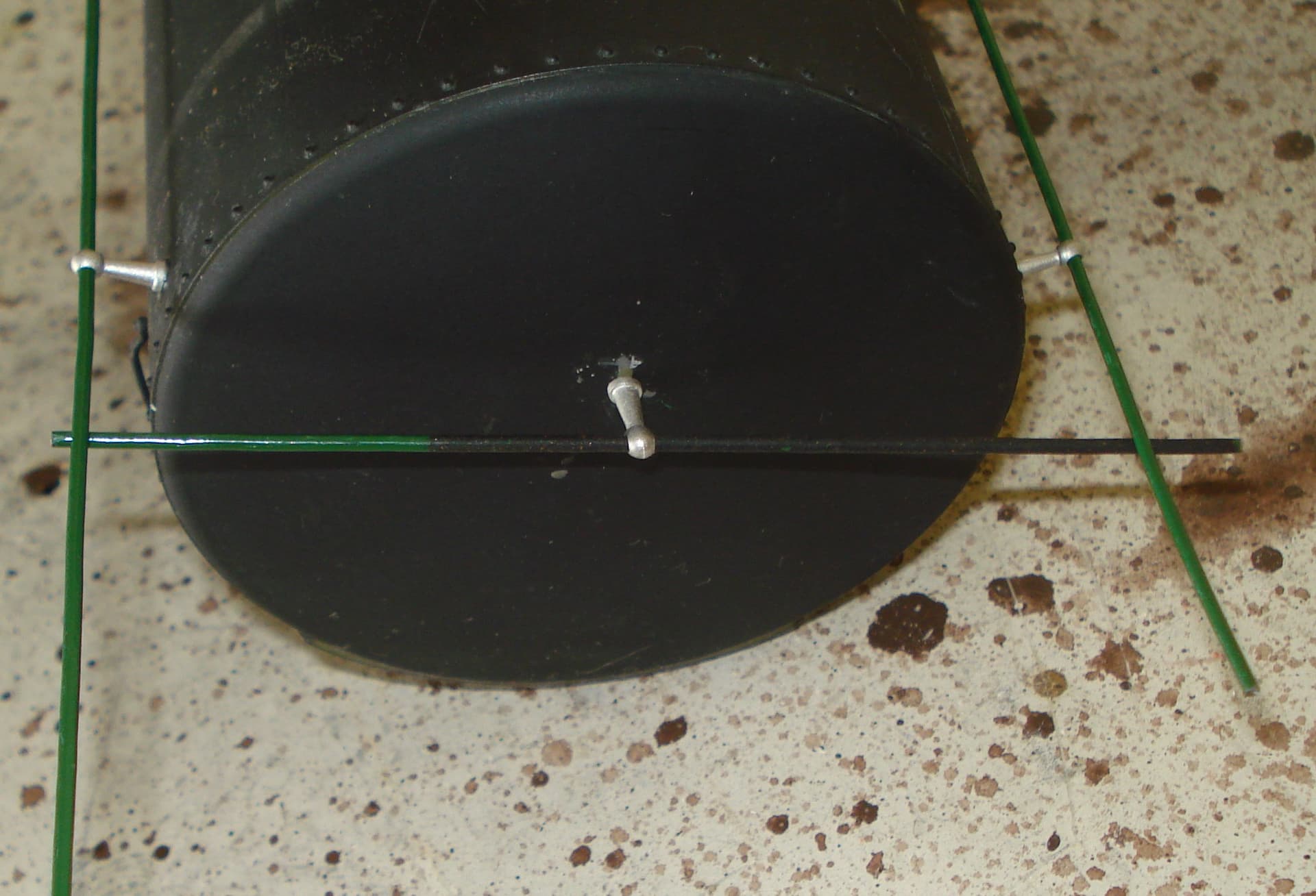

With them gone I was left with the factory holes. To small for the Ozark parts so they were drilled out and the new stanchions glued in.

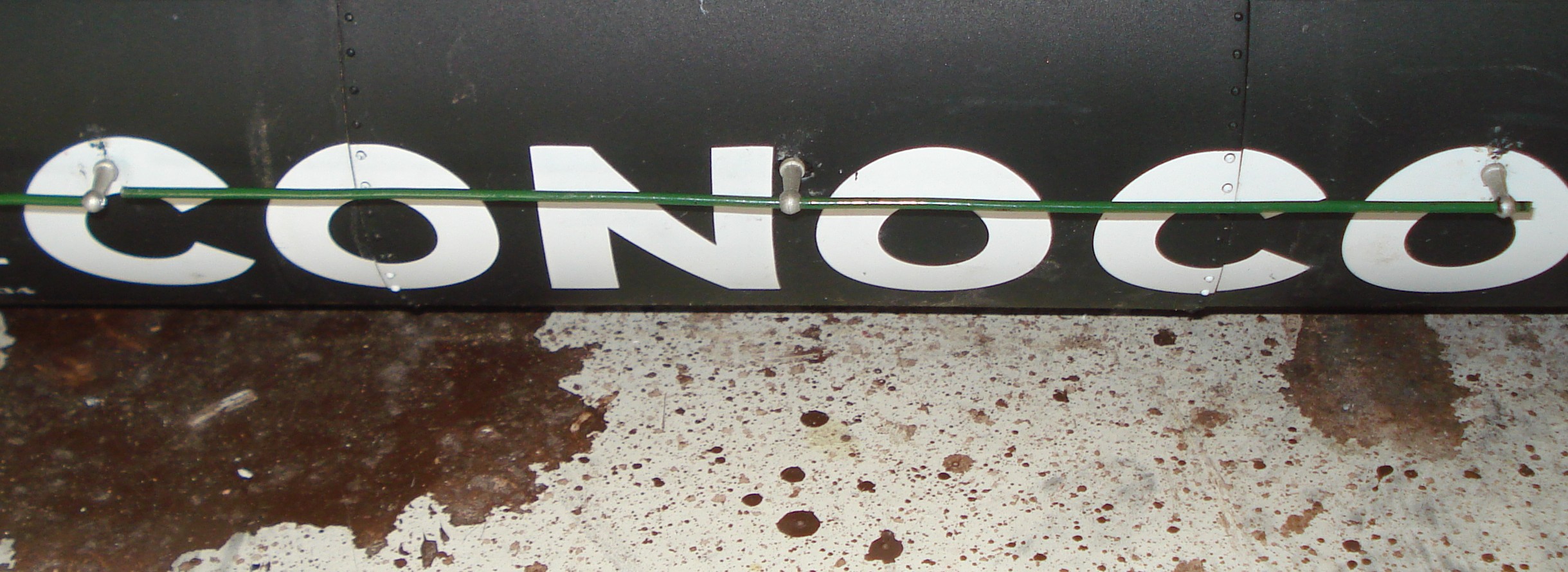

To make sure the holes were aligned I ran a length of stem wire through each side. The ones on the ends will be glued in once the new rails are formed.
The floral stem wire is not long enough to go all the way around from center stanchion to center stanchion. I will have to do it in four sections. The two ends and the two center lengths. The ends of every section will join inside the stanchion head.
I could order long brass lengths and do them in two sections but I don’t think it would prove dramatically stronger. Plus, I have a lifetime supply of the stem wire.
The wire is measured and bent to fit.
Once the ends are done the center sections are measured and installed. They span the center three stanchions to help give them strength and stability.
With all the pieces in place every joint now gets a drop of superglue.

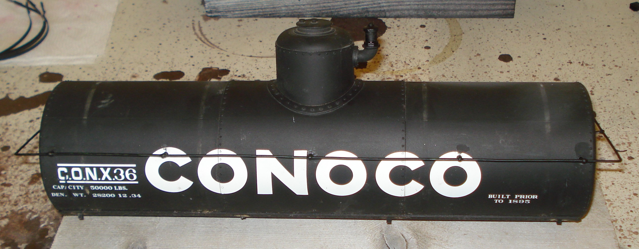

This was the hardest part of the tank. I was not sure how the wire would work out. Looks good and is much stronger and more durable than the original. Just need to let the glue cure before handling it anymore. While it sets I will get started on the car body.

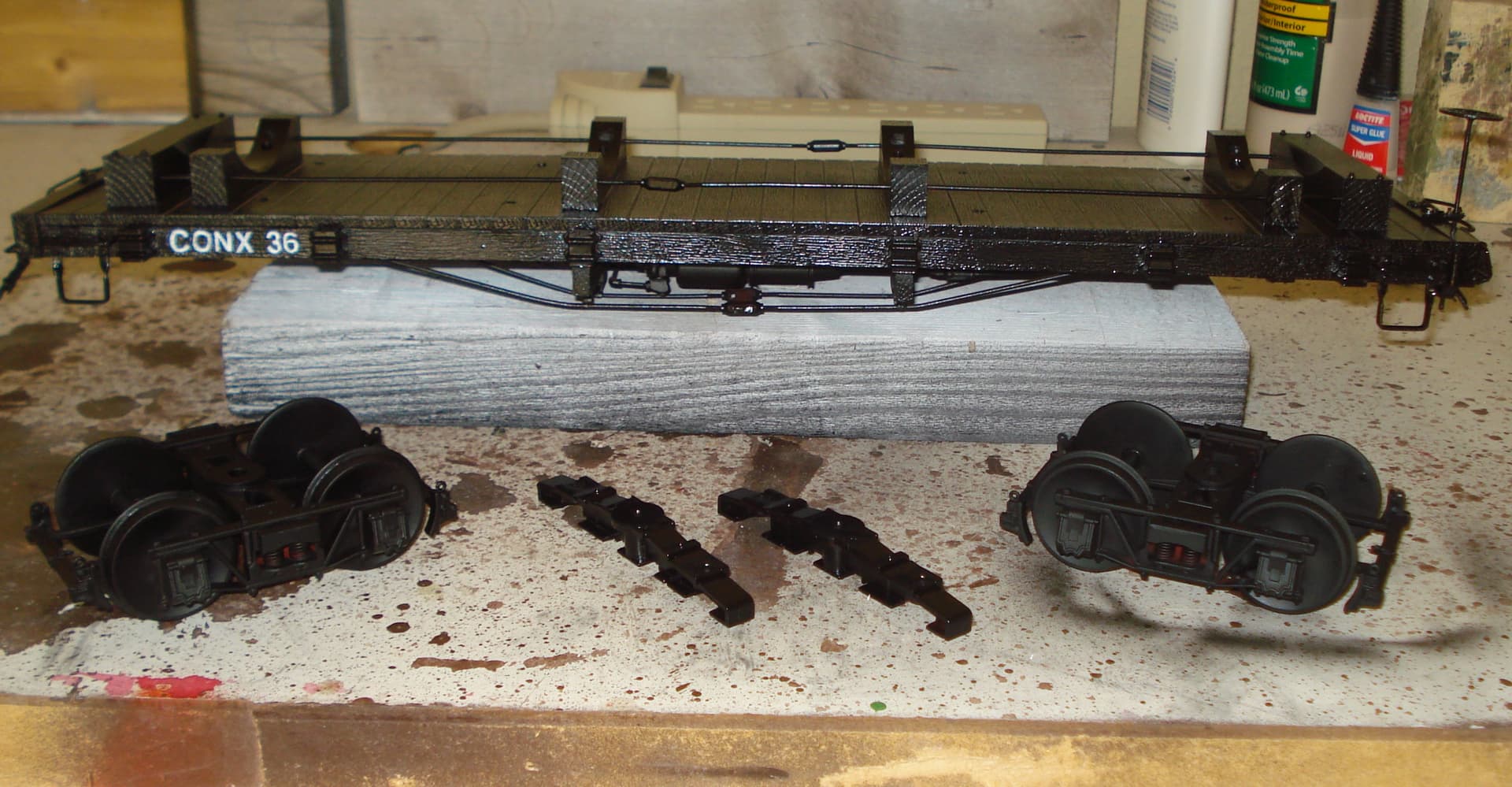

While the tank glue is curing I am working on the flatcar. I got the old lettering stripped off. A base coat of pure white where the new markings will go was applied. Once it was dry I placed the vinyl letters.
Black spray paint applied. Masking letters removed. The side of the car has a well defined wood grain that allowed some bleed-under on the lettering. It will need to be touched up with a brush. Since the spray paint goes on a bit heavy there is a lip to help guide the touch-up effort.
Here we go. The car body is all done. No spray cans were harmed in the making of this update and no new curse words were invented.

Other than painting there are two items to address before the tank can be reassembled.

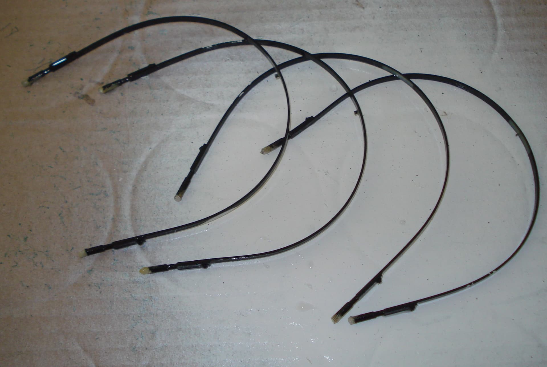

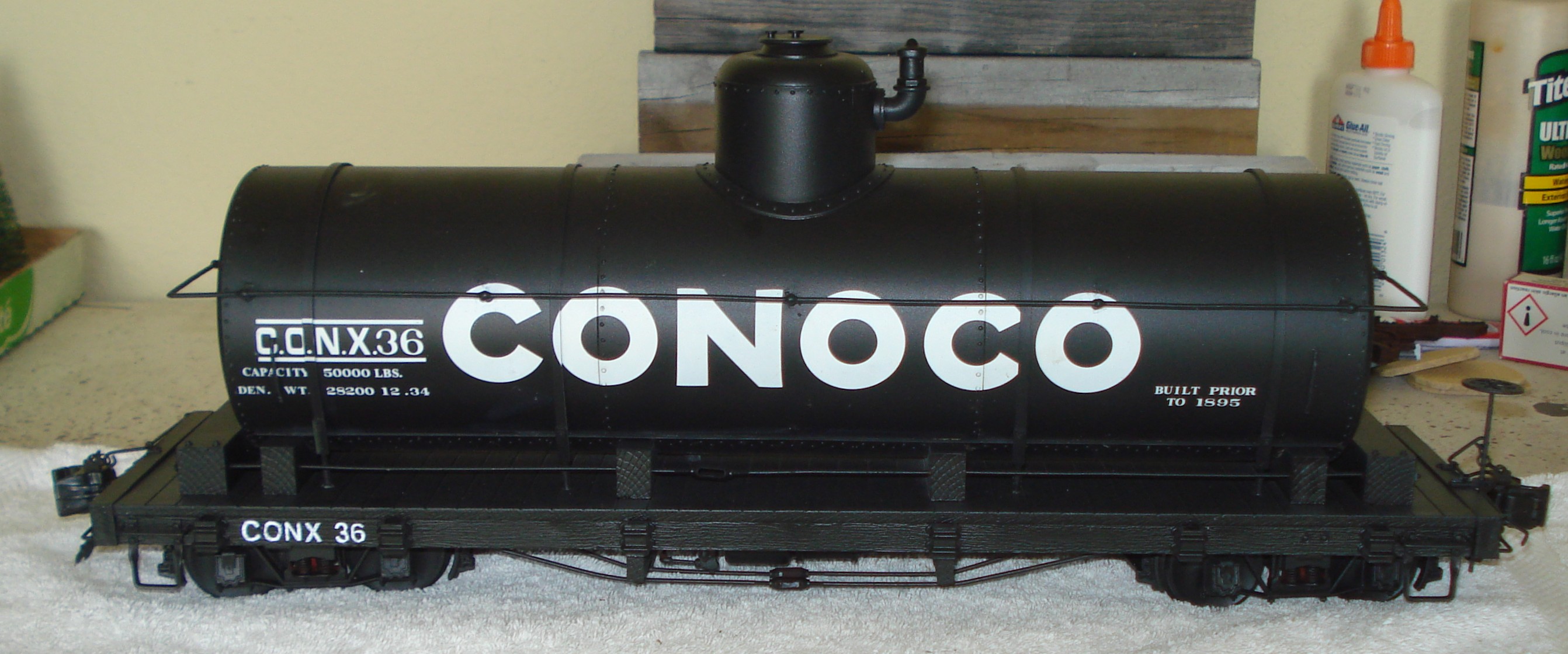

The first is the retaining bands. I thought I would have to use the ones from the Zerolene tank but turns out in my boxes of much junk I found the bands for the Conoco tank. These are made of cast resin epoxy and are very fragile. Usually when these are removed they break. But occasionally the ends pull out in one piece. Luckily that is what happened. All I will have to do is push them back in place and secure with a little dot of glue.

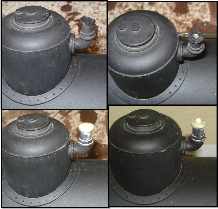

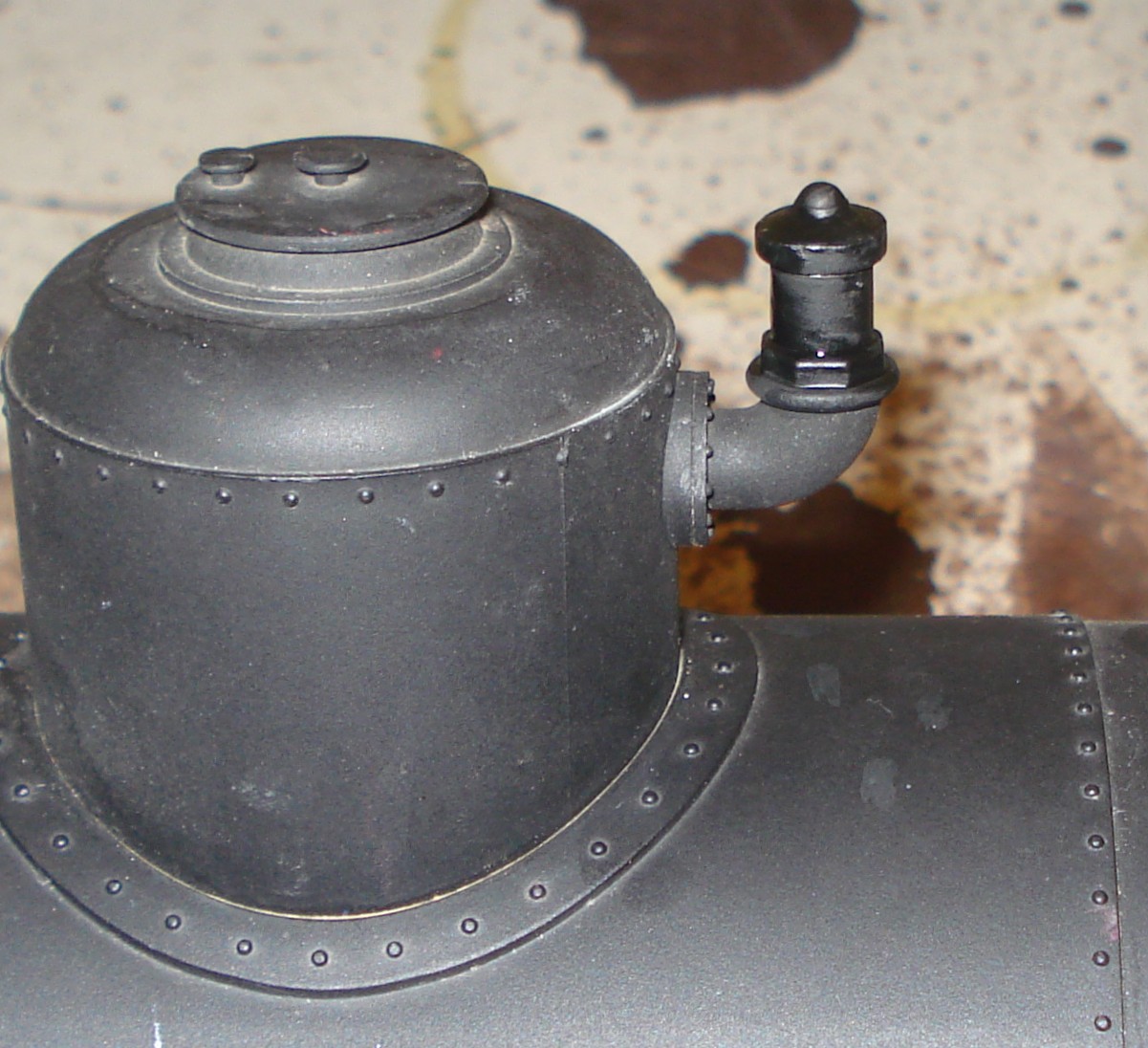

The other thing is the vent. It looks like it was factory painted so it must have been damaged at the time of manufacture. I drilled a hole in the top to give the epoxy putty a good place to grip. Next a ball of Milliput was applied. I roughly shaped it to the top of the vent. When dry it was sanded to fit. A pinhead was attached to the top.
Ready for cleanup and paint.
To make sure the Vallejo paints stick I captured a little of the solvent based black spray paint and brushed it on the vent and rails. It will stick to the metal parts and putty repair better than the water based. Wish I had sprayed the rail and stanchions before assembly. Even with some scuffs it would have been a better job.
The vent is still wet but after a dull coat it will blend right in.
The rails need a coat of flat black Vallejo to finish them.

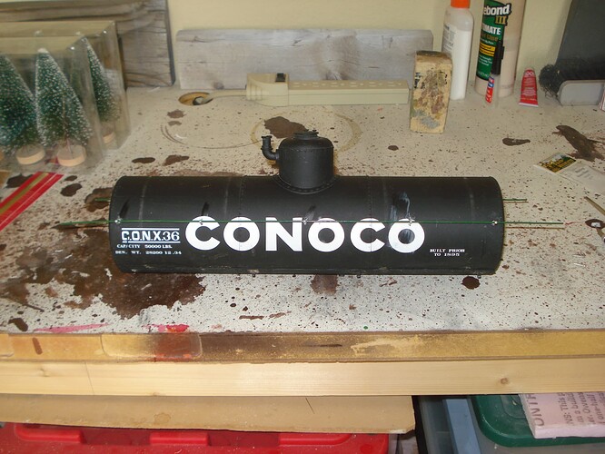

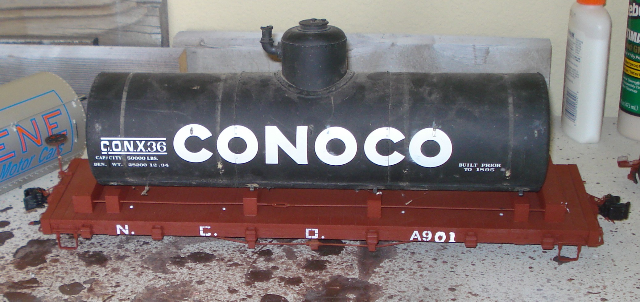

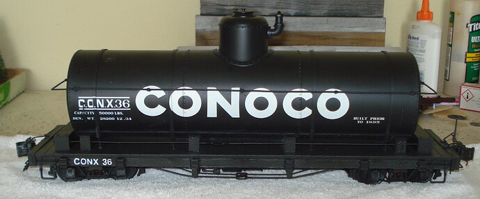

Got a few alibis on the white lettering and the whole thing is ready for reassembly.
Reassembled and clear coated.

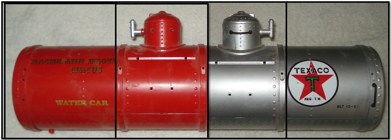

Time to return to the two dome tanker that started this whole mess.
Even though it will be a flatcar mounted tank I want to match this as close as possible.
The two domes will be toward the center with a ladder and platform between them. I also want to incorporate a more extensive handrail system. Something indicative of this. probably at mid level.
600x346_tcx1728

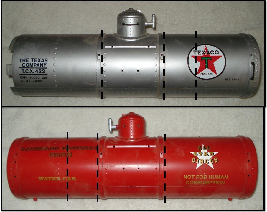

My first problem is to cut and combine the two tanks. The length has to fit the Spectrum flatcar. I think I should do the tank first. If I can’t make the joints look right or it just looks like crap in general I won’t have ruined the flatcar.
HiHo HiHo its off to the bandsaw I go. With a chop chop here and a chop chop there HiHo HiHo HiHo…
Great progress! Glad you are using the Bachmann flats. I have a bunch of the Accucraft tank on flat cars and even with all the recommended mods, they do not track very well. The only problem I have with the Bachmann flats is coupler swing. They don’t like my tight crossover switches and will lift one side of a truck if coupled to another car.
