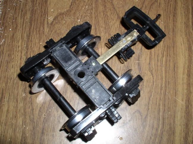

Once upon a time (all good stories start that way, right?) there were twin (except for road numbers and 15 years of production) Bachmann bobbers. They were ungainly, didn’t run very well, and were generally unloved. Then they met Mr Razor Saw, and their ho hum existence changed dramatically! Caboose #1, fast and simple: I took a Dremel and cut away the 4 wheel underframe, then mounted trucks.
To help tracking I did away with the body mount coupler on the front side, and made a custom length targa one.

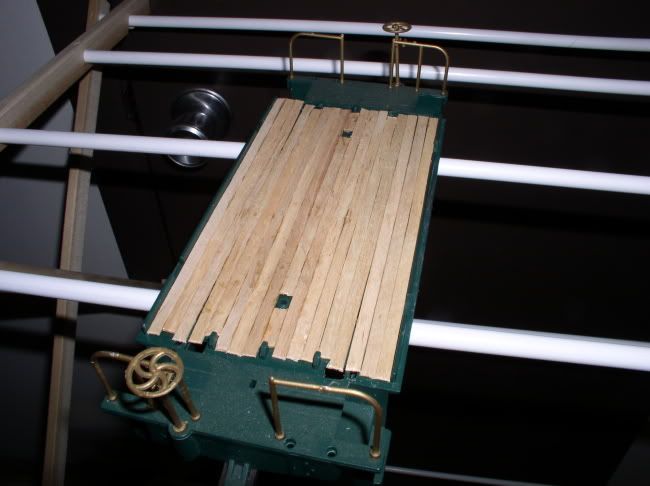

Coffee stirrers make great floorboards

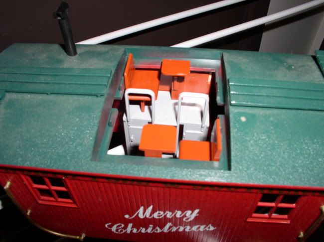

LGB cupola interior and cabinets were added
I scratchbuilt the rest, including a pair of nonfunctional sconce lamps (I did buy the stove, not shown)

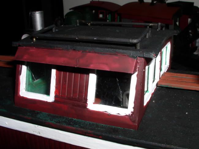

Then I blanked off the center window and added sunshades
2 evening’s work from start to (almost) finish

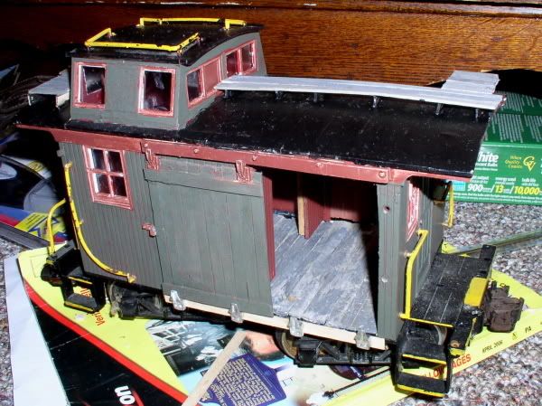

Caboose #2, a backwoods logger (actually done first, but much more involved) Same basic treatment underneath. Then I cut a HUGE hole in the sides and moved the cupola
Ozark boxcar guides and stuff and coffee stirrer side doors
Full scratchbuilt interior (including a stove made from a wood bead and scraps)
Just the ‘right’ amount of clutter. Visually interesting, yet still a safe work environment.

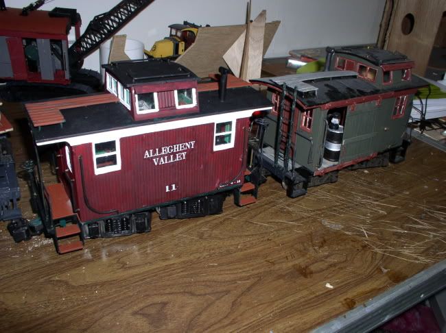

Now more like fraternal ‘twins’ with VERY different, distinct personalities!
And they rolled happily ever after… their trains
