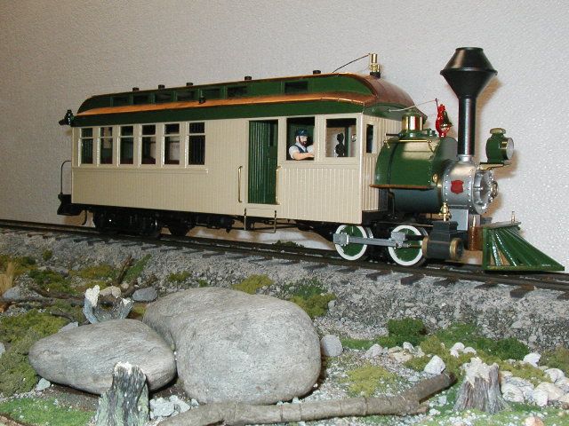

Todd, Here’s a steam coach I built using a Bachmann combine and North East Narrow Gauge Porter kit.
(http://www.largescalecentral.com/FileSharing/user_2849/My%20Trains/Steamcoach-1.jpg)

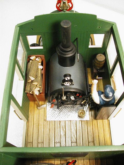

Here’s the front showing the cab interior.
(http://www.largescalecentral.com/FileSharing/user_2849/My%20Trains/Steamcoach_cab.jpg)

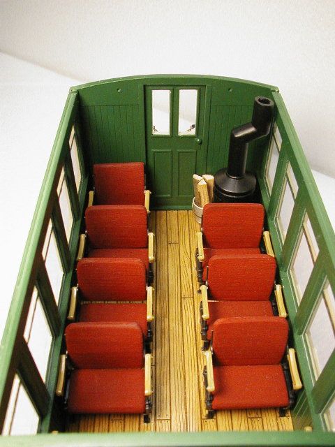

Below is the rearview showing the coach interior.
(http://www.largescalecentral.com/FileSharing/user_2849/My%20Trains/Steamcoach_coach.jpg)
I removed the NENG drive and replaced it with a Magic Carpet drive mounted on the rear truck. Hope this helps with some ideas.
