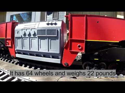

Here is a new video that shows the carriers I made to transport my Schnabel car ends to the track. It also shows how the loading deck is attached and a new Transformer load is connected . I used wood, plexiglass and a bit of 3D printing to make the transformer.

I have been improving on it since the end of the challenge including building the 2 loads for it.

The pin in the middle keeps the lifting arms rigid and from shifting while be carried to the track. I did design the end supports on the carriers to fit in between the lifting arm ends so they would not move much. The pins are just more insurance.
The real deal does mark the units A and B and I will do that in the future. I did mark the pieces when I was building it because as much as I tried to keep them exact they could be off a fraction so the A front truck might be off if it was put on the B frame.
Overall I do not think it matters. There is no real front or rear.
