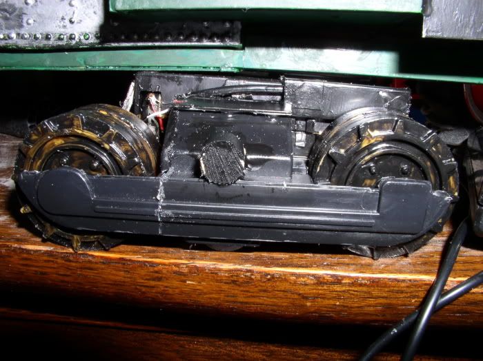

I already had a really cheap battery operated crawler in my junk box that I picked up at a flea market for 50c (yep, me heap big spender!)… I promptly gutted it for what parts I could use.

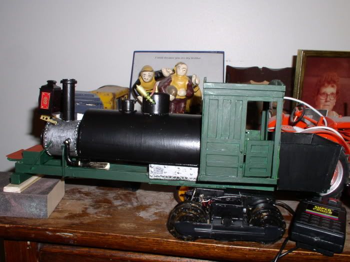

The narrowed and shortened crawler drive stuck under the Lombard… I need to shorten and splice the tracks yet!
I replaced the too small steam dome and chimney, and gave it a first coat of color. Yes, I know that the drive is sitting too far back. I just wanted to see what it looked like. I’ll also need to cut a section out of the frame to clear the drive

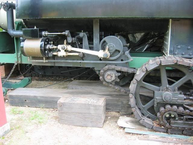

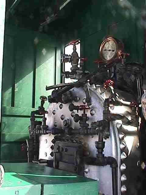

Cab details of a restored Lombard in New Hampshire

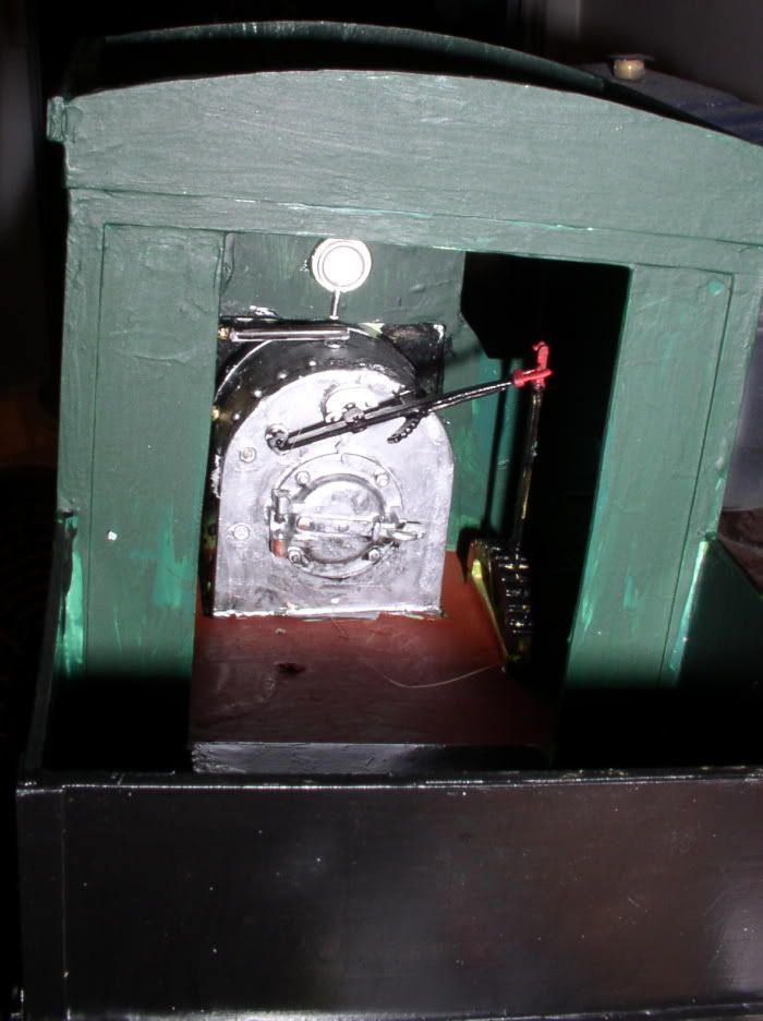

Cab details started. I had to strip most of the details that were in it when it arrived and start over
The steam cylinders will be fun to build. Everything I have here is too big. Might have to go see the Lionel/Williams dealers! I’m planning on trying to make things able to go 'round via a spring belt drive since the crawler drive actually works.

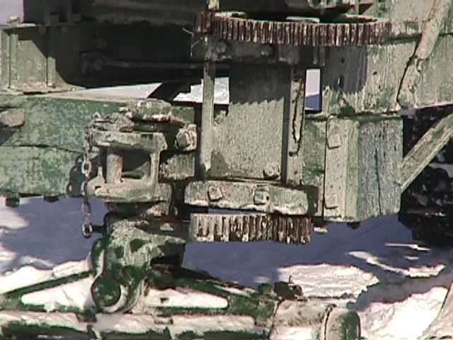

Steering gear LOOKS simple enough. The trick will be making it sturdy enough to work without looking clunky. I already have nylon gears here.

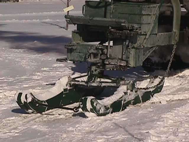

Skis? I do have some tiny wood spools to build hidden rollers. Another option would be wheels, but log haulers usually pulled sledges on ice roads during the winter months.
