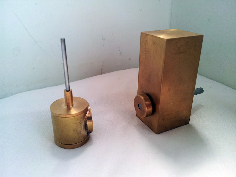

This is the design of oscillating engine that I will use as a reference for the scratch built one
