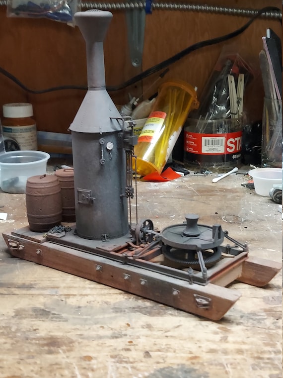

7/8 Dolbeer steam donkey
Finally got her finished.

That’s beautiful John, but for a Dolbeer it sure makes that track work look small :grinning:
Rick, It’s just a little Dolbeer. :grinning: :stuck_out_tongue_winking_eye:

That looks great, John. Love all the little details.

Beautiful! Great coloring on the wood. I’m not a logging RR, but I have several Shays and one of these in Fn3 would be an awesome flat car load for them.
