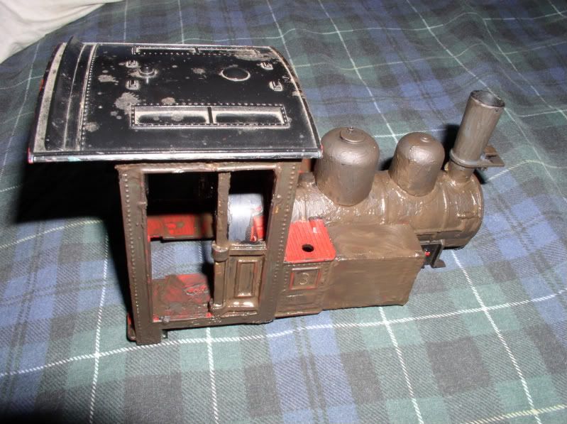

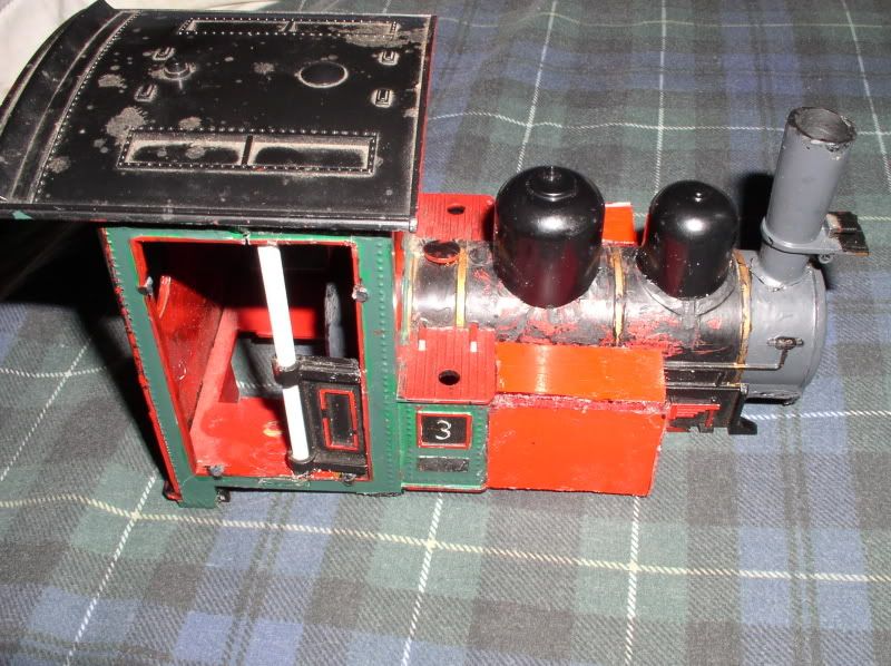

And now for something completely different… Since I have all this newfound outdoor space, I decided that I wanted to expand my coal mine complex. One of the things I want to do is a minecar tramway. In 1/24 O-gauge is right near 30", absolutely perfect for a little tramway. SM32 (16mm/ft scale, 32mm gauge) is fairly popular in England, but the stuff is pretty scarce over here. A coon’s age ago I bought my oldest daughter an obscure product from the German company Faller. They called it the " ‘e’-train " It was a sort of cheap and cheesy 2 rail O-scale mechanism stuffed under a 1/25 or so superstructure. The thing looked sort of like a 6 wheeled Stainz that shrunk in the wash…
She ran it under the Christmas tree one year then put it in a box, but so far has resisted all my efforts to swipe it back. – What my daughter didn’t know is that all this time I’ve had a second locomotive hidden away ‘just in case’… This one was fair game for a bash. Mods so far: Chop off those German domes, shorten the chimney, re-work the cab, extend the side tanks…
[/IMG] more pix later

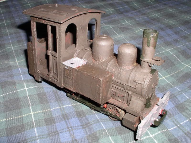

A bit more progress. I decided, since it was working the mines, that this one was to be decrepit and dirty. To that end, the body got a coating of raw umber.
(http://i397.photobucket.com/albums/pp52/steamnut1917/mine/P3240003.jpg)
I decided to add a short coal bunker to the rear. I also added some Plastruct box to the top of the cylinders for valve chests, and a real wood buffer beam (which I chewed up with the Dremel to distress it a bit)
(http://i397.photobucket.com/albums/pp52/steamnut1917/mine/P3250003.jpg)
Next step is to add some weight (the original one was lost before I acquired it) and a few details. It’s going to be VERY minimal compared to my usual stuff… partly because there’s really no room to work, and partly because it would be sort of like gilding a turd.
