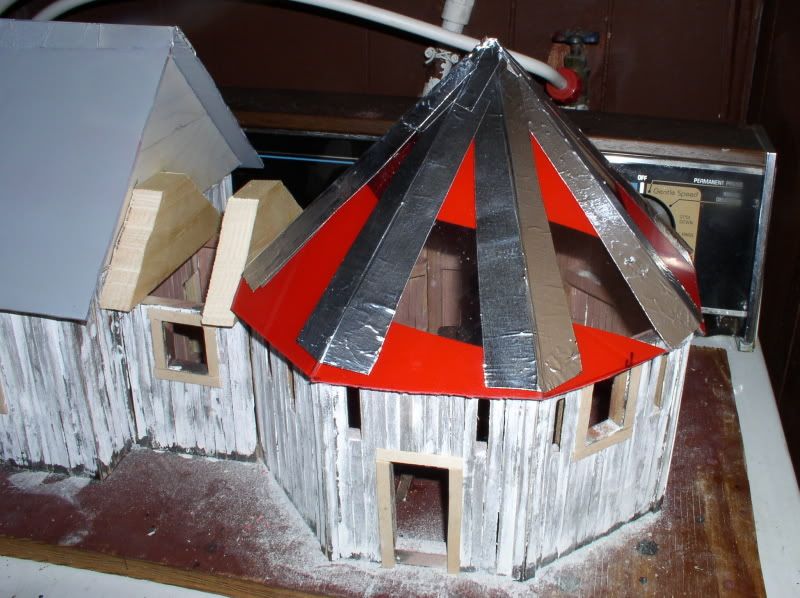

The sides are just glued with Elmers. I need to connect the corners with wires like the original. The roof trusses are tacked in place with Welder contact cement, but will lift off in 1 piece when I’m done, just like the enginehouse roof. Only the compressor/condensor room roof will be fixed
If the challenge had ended yesterday, this is what I would have had to show… I trimmed the eaves since then

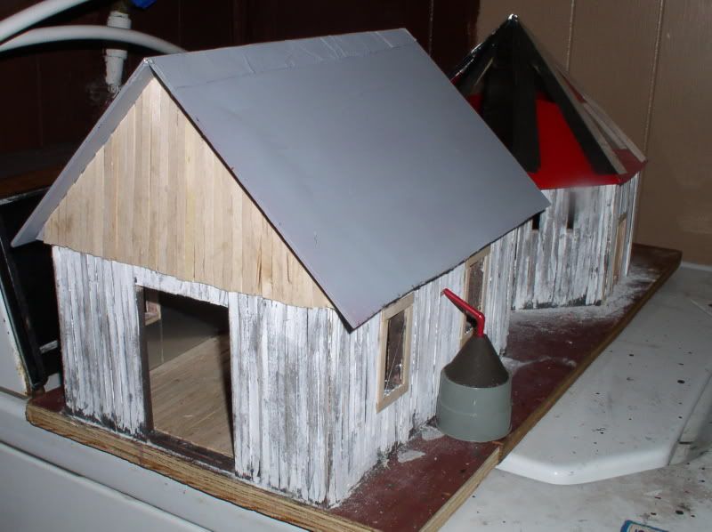

Okely dokely, it ain’t gonna be finished nohow, but at least it’s starting to look OK Enginehouse got the windows framed and one gable boarded

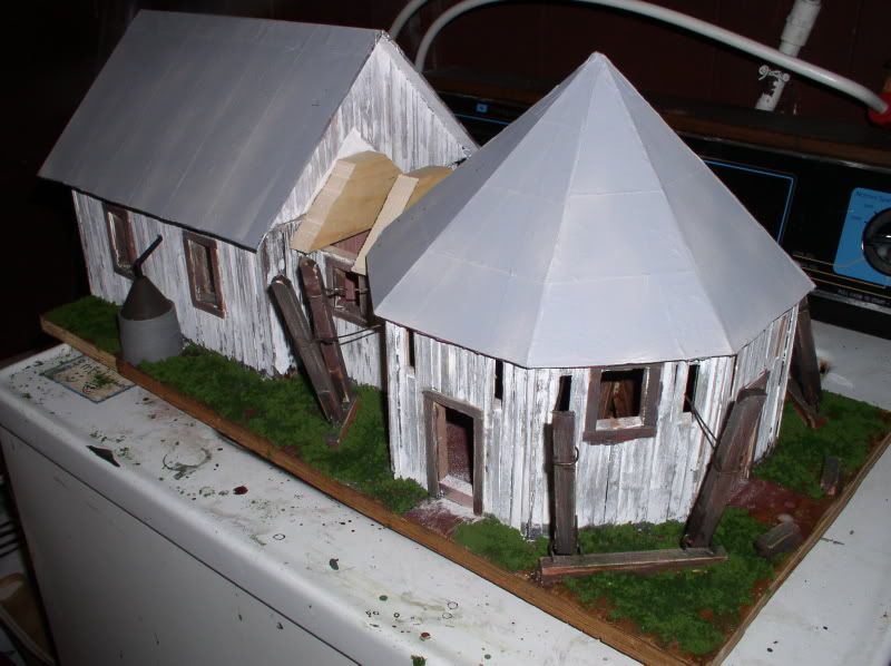

Powerhouse got a roof of sorts. It needs a few small adjustments before it gets surfaced and painted. It was too windy to spray it this evening anyway.

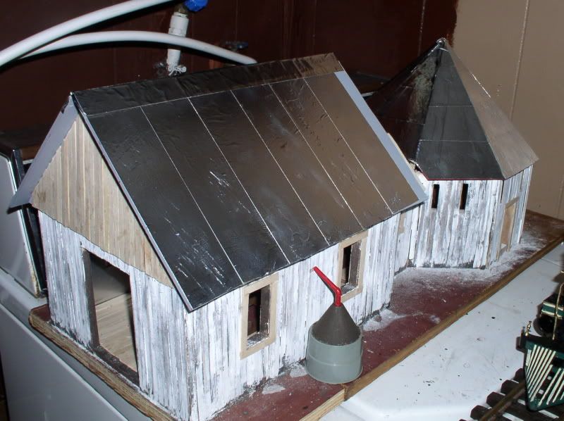

Well, it ain’t near finished. But I got a bit more done, anyway. I started by covering the roofs with aluminum furnace tape. The prototype had tin on the enginehouse and cedar shingles on the powerhouse. The furnace tape can be either flat sheet iron or tarpaper depending on how I decide to finish it.
