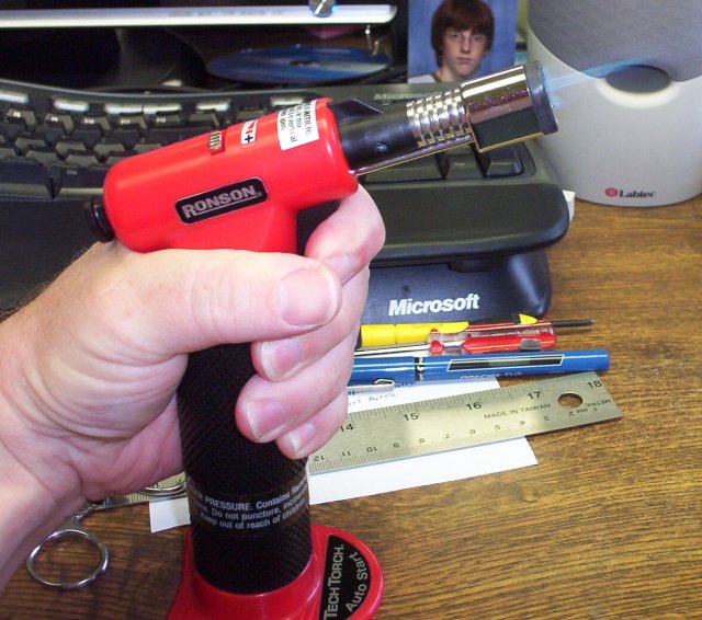

Doesn’t seem to have what it takes to solder 1/4 inch brass tube… Maybe time for yet a bigger tool.
Soldering guns are a problem. They don’t have enough heat storage. What you need is a LARGE soldering iron. I have an iron that is about 100W and it really solders anything.
260W soldering gun will conquer the problem.
So will a blow torch.
Sure will, but … perhaps Tom doesn’t like to play with fire.
hehehe Tom the Brat plays with fire! Dad had this monster iron I could solder ANYTHING with, like model airplane landing gear of 1/8 inch spring steel. Never had one come apart. In spite of the huge cork handle, I had to wear gloves to use it. Now, I can SOLDER!
