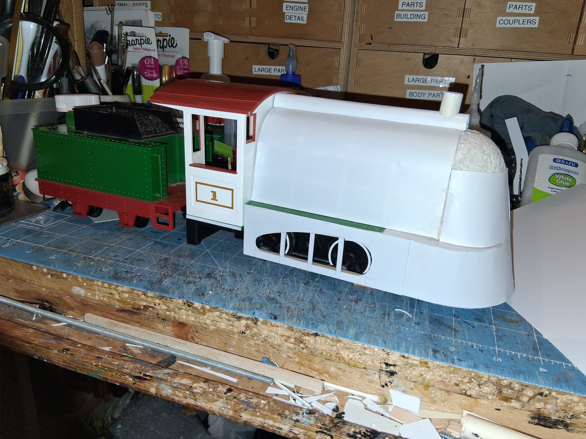

Thanks, the framework is actually an extension of a past Mik Challenge, The Silverfish. But that one I took the easier route of building it like an RC plane, with tissue over the framework. This Challenge I’m going to cover the framework with styrene which is going to be a much bigger challenge as I have to cut it to match curvatures. I’m planning to stretch paper over the framework and trace the shape then transfer that onto sheet styrene. We’ll see how that goes.

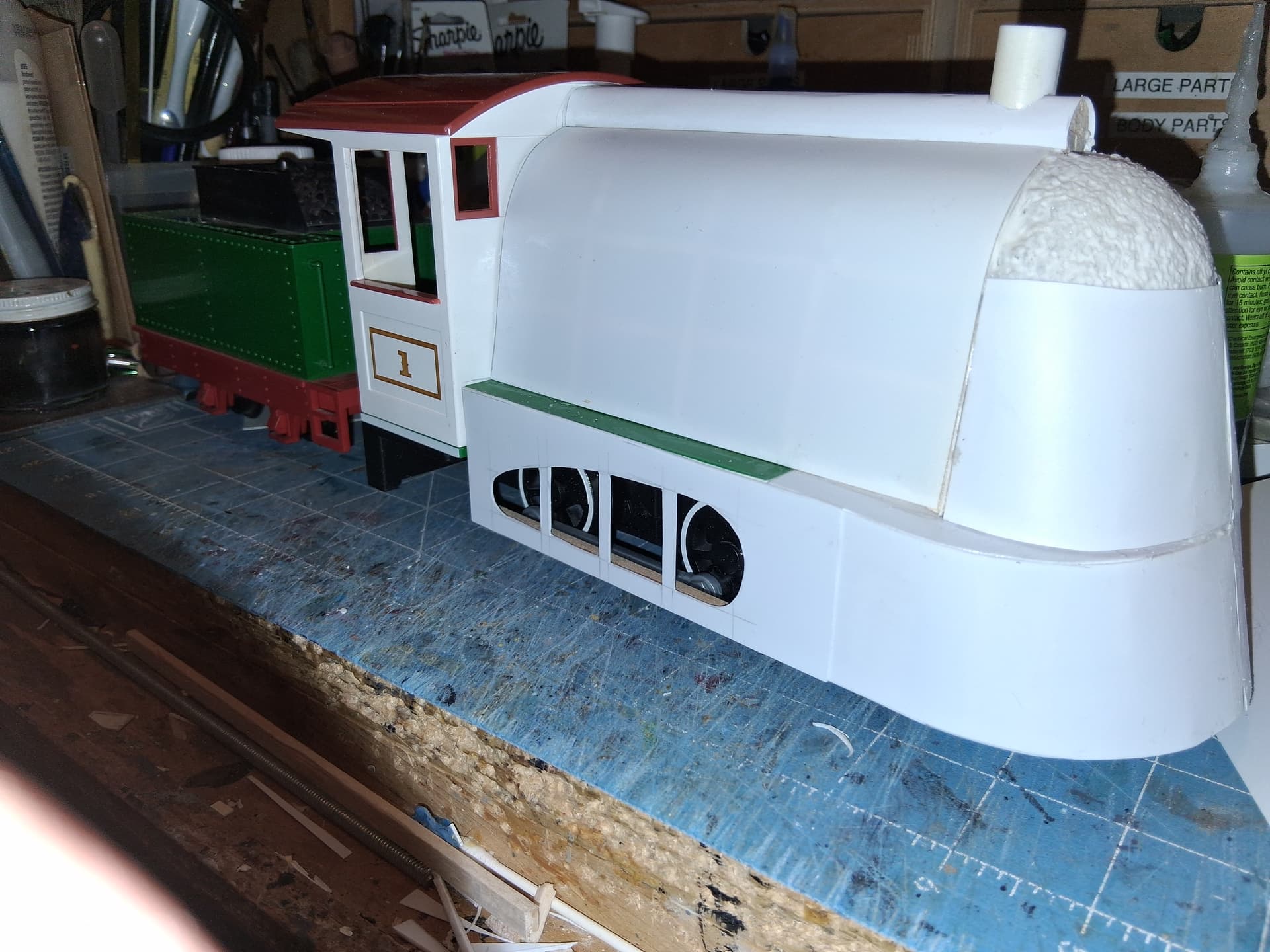

Oy vey, got this far. My paper pattern overlay worked out really well. I’m glad this part done.
I think I’m going to be spending the next 2 weeks puttying and sanding that small area on top until its smooth. What i really need is a vacuform machine but too late for that. I might have a heat gun in the garage (if I can find it) that I can try and shape a sheet of styrene over one of the extra styrofoam balls.
i would doubt that. the styrofoam would melt before the styrene.
what speaks against plaster hole filler and sanding it down?

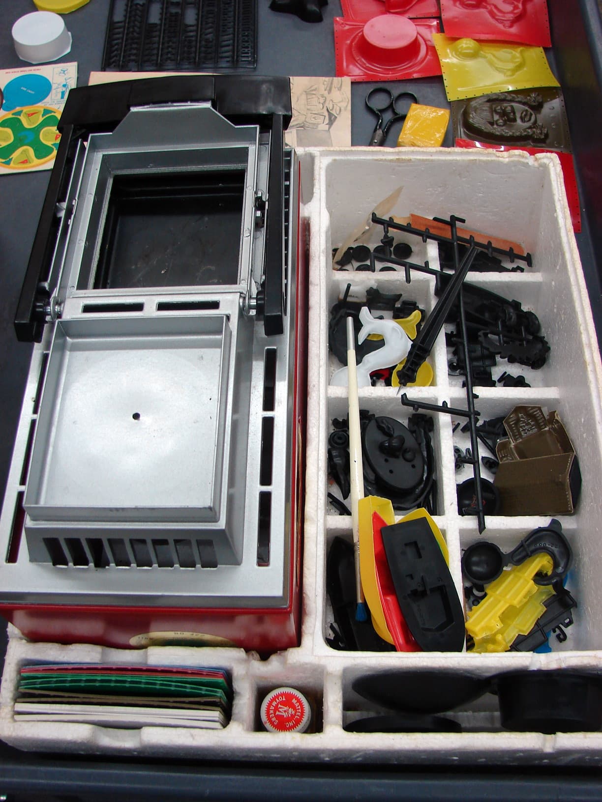

Korm, I was going to glue down the ball, heat just the styrene sheet then place it over the ball. I only needed a 1/4 of the sphere, but I checked an my heat gun is busted so I’m back to painters putty and sanding. On layer 3 its coming along just very slowly. Luckily the putty dries in about an hour and sands well.
Wayne, let me think about that :thinking:
You obliviously did not have a Vac-U-Form when you were a kid. You didn’t experience breathing toxic plastic vapors or making scary bugs.
Ok Wayne!
Vapours you say?
With that recommendation, I’m putting it on my to buy list.

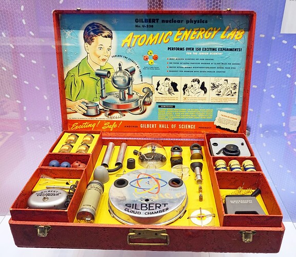

That’s nuthin. From the Wikipedia description, this kit contained "four glass jars containing natural uranium-bearing (U-238) ore samples (autunite, torbernite, uraninite, and carnotite
Sorry, I digress… Vic, you bet, heated clear plex. And you can always say “I didn’t inhale.” :grinning:
