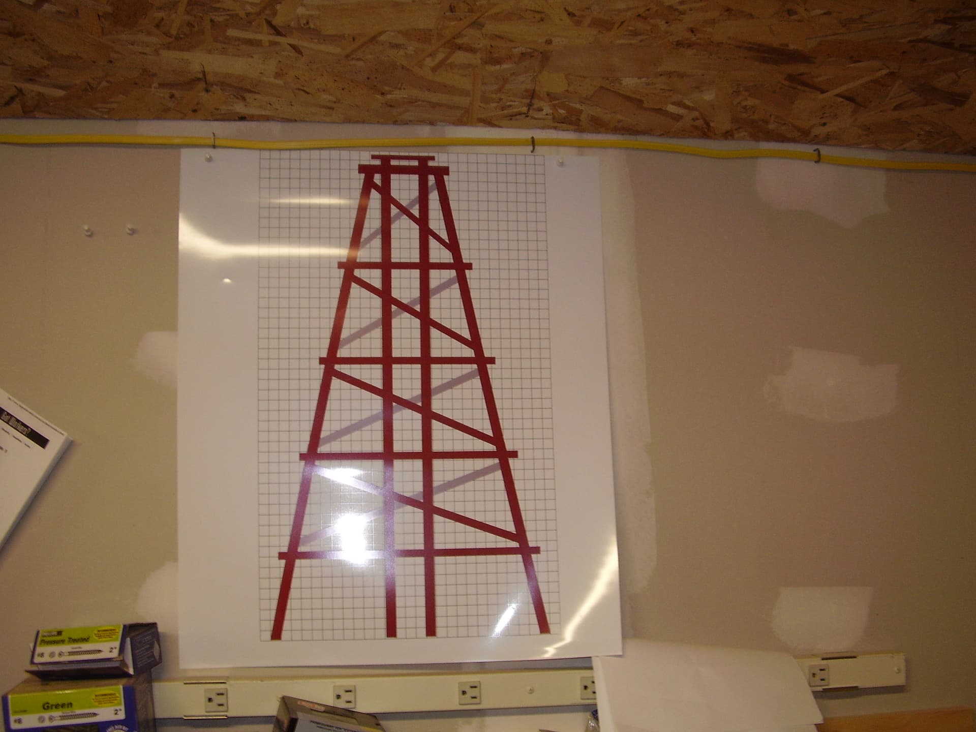

Trestle template
Cliff

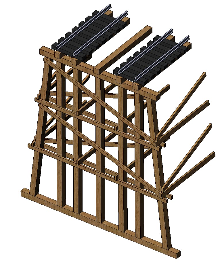

Could you draw in the two sections of say LGB track on the top for a visual representation of two tracks?
Great scetch and I love your logic and I think the same
You bet Sean, thanks. It’ll be tomorrow evening though, since my better half is about to ring the dinner bell. :grinning_face_with_smiling_eyes:
Think I gave this to the nark cop Shawn V. 15yrs ago.
Cliff, great representation of what I tried to put into words. The sketch and model are spot on
Am I understanding correctly? With Parallel tracks, separation should be 7 inches center to center? And if that’s the case any railings should be 3.5 inches off center each side? Would this mean that if I went with a plate girder bridge it would need to be 1 foot 2 inches wide or 36cm wide?
Bill,
That sounds about right. However one thing to note is those calculations are meant for a straight line. If the bridge is built going into a curve or out of a curve you may want to widen it a bit if your on a tighter radii or running longer equipment.

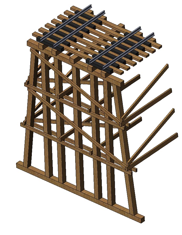

Sean, here’s what I was thinking of rails, assuming it’s hand-spiked onto wood ties. This is showing a 7" CtoC track separation.
The LGB track would replace both the rails and ties of course; but with this dual-track thing, the plastic ties wouldn’t meet at the center… The gap between them might look odd, and the center joist would probably go away… Thoughts?

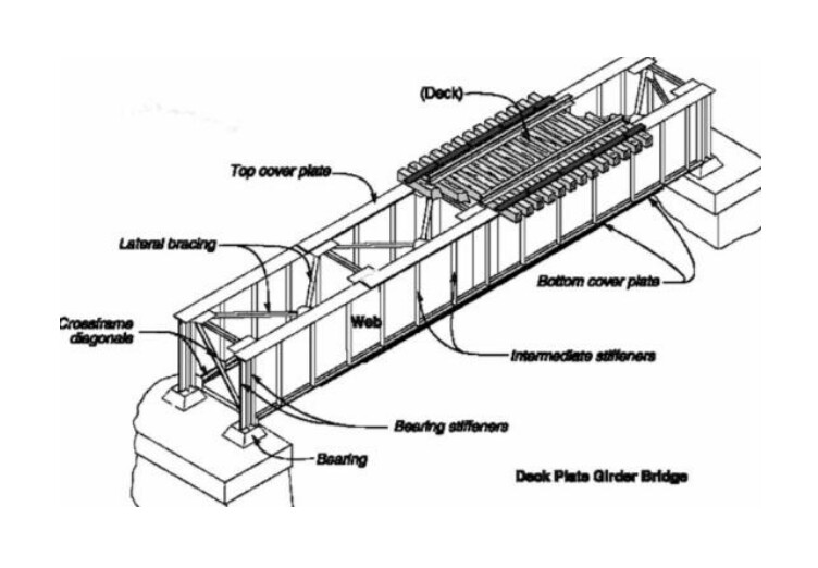

If you use a deck girder bridge approach, where the girders are beneath the ties, the channel could be much narrower since its walls support the rails (and the ties extend beyond).

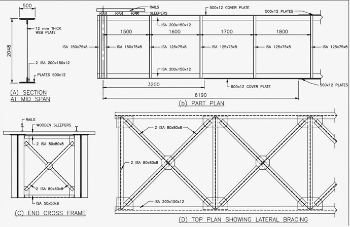

You could then use two parallel ~2x2 channels, perhaps screwed to each other with 5" wide spacers of some sort. I got the below figure from here.
Here’s another drawing from here.

I was thinking of sectional track
Understood, but that leads to this gap I was referring to.

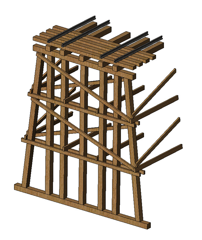

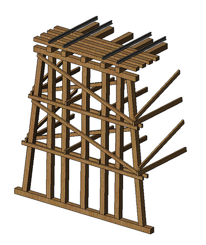

I suppose you could put in 1/2" x ~1/4" planks between the ties, to span the center and get the outer walkway back.
[edit to show the planks]

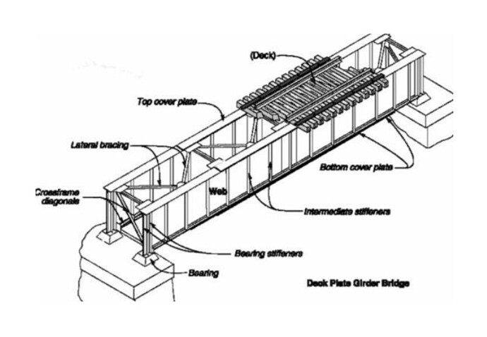

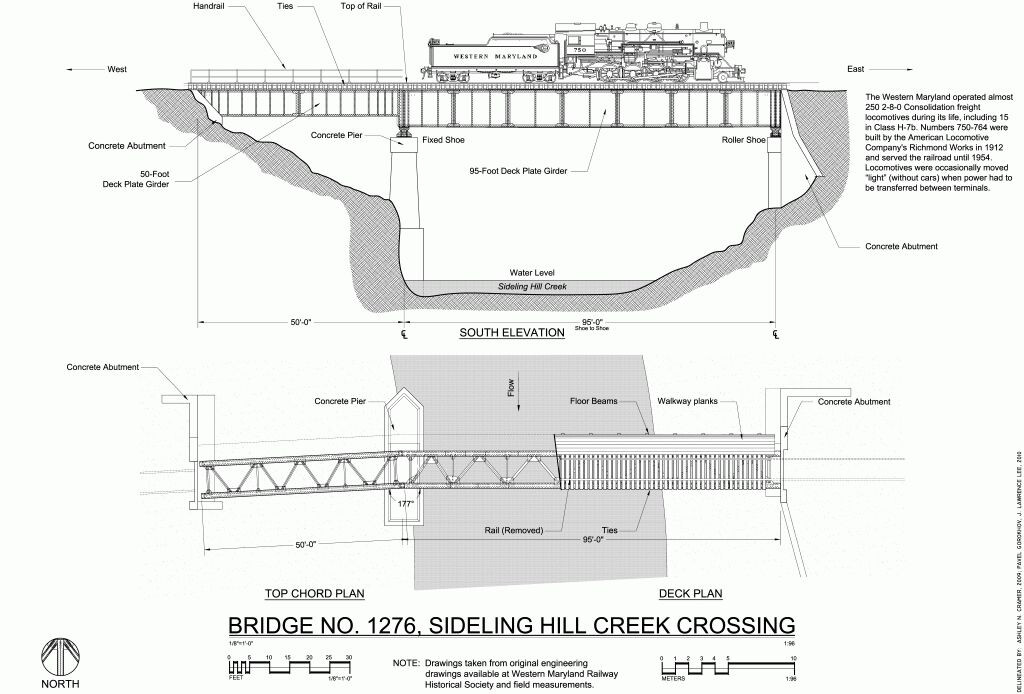

FWIW I like the deck-style plate girder, because in selecting the thickness you can make it much stronger than a stick-built trestle, as long as the piers are stout. Like, concrete pylons, which is what many of them are / were. This one was in our neck of the woods:
Interesting that one end of the main span was on rollers, I presume for differential expansion/contraction.
This and two detail sheets are here.
Interesting that you brought this up As I noted years back that rollers are used. And you are right on the movement issue.
While rollers are used to allow for movement due to thermal expansion and contraction, they are typically only used on one end of a bridge span. One end is usually fixed to prevent longitudinal movement, while the other end is supported by rollers to accommodate expansion and contraction. In multi-span bridges, rollers may be used at both abutments, with fixed supports at the piers

So you make me wonder if the issue might affect a long aluminum channel for a garden RR bridge.
According to this site, a 10’ channel, experiencing an 80F temperature swing, with 0.0000128 being the coefficent of thermal expansion for aluminum, would be about 1/8".
At our scale, rather than rollers, a piece of UHMW sheet on one end would let it slide some. Maybe combined with slotted holes + screws, or some other guide. Otherwise, if both ends were firmly attached to a pier, said piers would be rocked slightly back and forth.
Or attach the channel to the piers with well nuts.

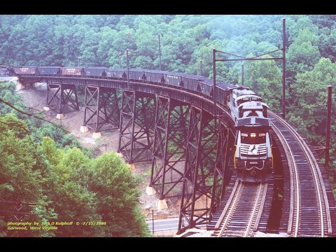

Thank you Al, I wasn’t gonna say it cause I’m usually incorrect. However there are steel versions out there and even on curves that go into a tunnel.
Since everyone is google expert here I will just suggest looking into the Garwood Trestle in WV.

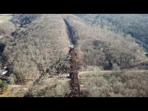

However if you want to see it on you tube look here
I will also say that I’m very surprised Bill didn’t dig this up as he’s good at resurrections!
Then you could really send Bill down a rabbit hole down the old Enola Low grade line in the Safe Harbor/Martic Forge area.

Nice citation, Rooster. However, those look like deck plate girder bridges that land on steel piers.
Not a trestle.
If you say so governor!
:rooster:
Well… maybe I’m misunderstanding “trestle.” A series of piers, with bridges between them, might be considered a trestle, but that would surprise me. I’m no bridge expert though!
