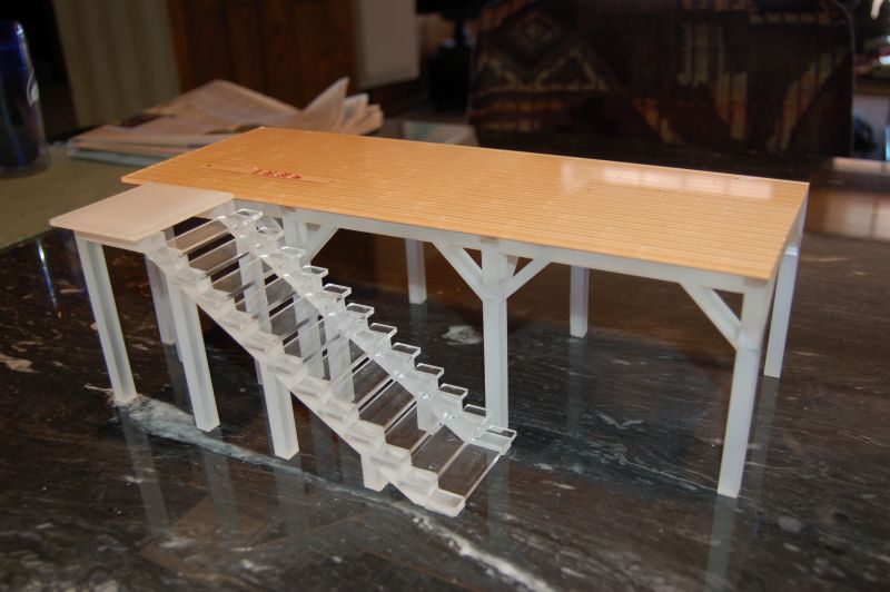

This shows the stantions with the cement grouting. I’ll have to touch up the paint from the grouting and a couple spots need a bit more grout.
This shows the effects of etching the acrylic for a grain. Maybe a bit heavy, but paint will tone it down.

Good job on the stones. Mortaring the corners with cement really makes the stones look realistic. I like the wood grain effect. Not to heavy to me.

I put the structure on the railroad to get an idea of how it looks in it’s setting. Not bad, and certainly a one-of-a-kind item that you won’t see anywhere else. (My favorite type. (http://largescalecentral.com/externals/tinymce/plugins/emoticons/img/smiley-wink.gif))
This also demonstrates another “flaw” when using the laser. (They are not perfect.)
If you look at past pics of the deck and landing for the stairs, they were nice and flat. The heat generated on one side of the piece during the etching process combined with the removal of material from that side, made the parts bow. I’ll now need to use a hair drier to try to flatten them out, rather than induce the bow into the structure.
