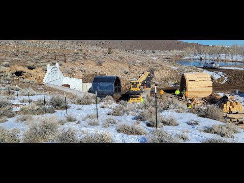

A few days ago, some wonderful work was done on the real tunnel. It’s mouth had caved in, but the portal remained. Here’s how they used a steel vault behind the portal, gradually pushing it inward as the timber lining is being installed. I’m not sure how far they’ll go on current funding, but this is an amazing start.
