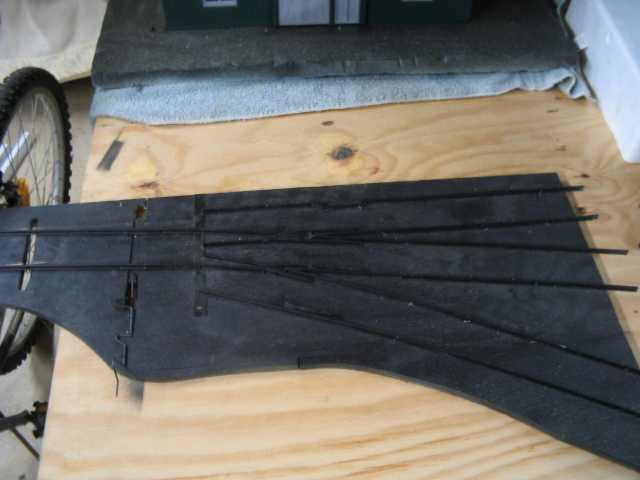

Lets see teh stub switch!!! I can;t say enough about having even just the locomtives on hands free storage…perhaps as things develop a small cover might appear over my staging yard as well…But the staging yard first!
This here’s the one on the outside layout.
This is the one for the inside portion…rather crude, but functional.

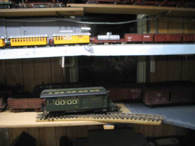

This is the area it will occupy. (Sorry fo rthe picture quality, it’s rather dark out there and the flash doesn’t work.)
Geeeze!!! Ken don;t ya know its too early to be out there prowling round taking pictures??? Ilikt eht three way…whats the details on its construction?
Bart Salmons said:
Geeeze!!!! Ken don;t ya know its too early to be out there prowling round taking pictures???? Ilikt eht three way....whats the details on its construction?
Not much details to it. I just kinda winged it to have it fit in the space it needs to occupy. I drew out the basic outline of how I needed the tracks to go and just started tacking down the rail. It's aluminum code 250 mounted on a 1/2" piece of plywood. The moveable track has 4 rail joiners slid over them that are tacked down to the wooden drawbar linkages to keep the rail in gauge over the long throw it has to travel. The throwbar or switch mechinism is a heavy piece of wire that's been bent and hooks over 3 nails at the proper positioning points. .
Ken ,
That’s what I like to see , a practical approach to a problem . Nice one .
