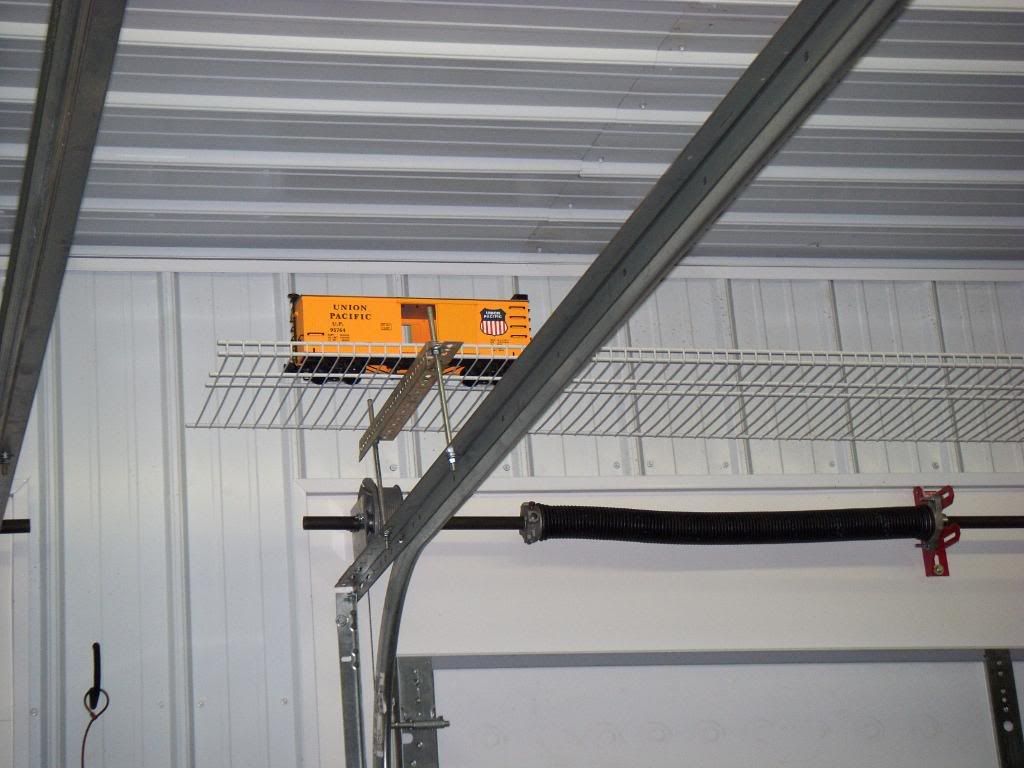

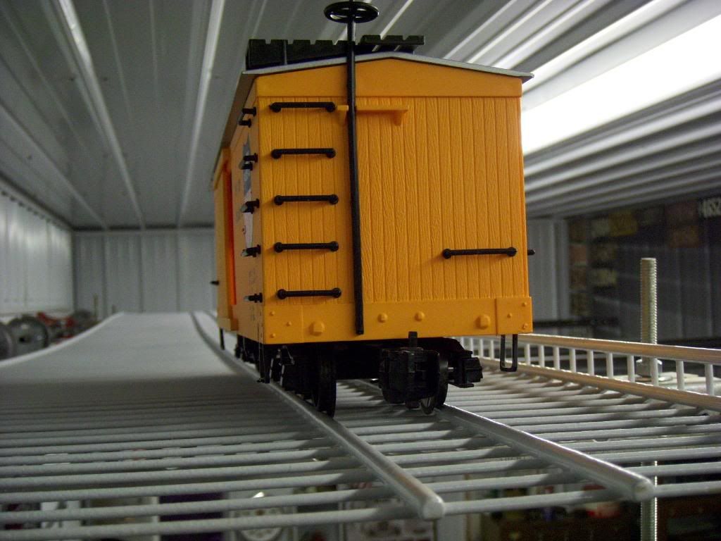

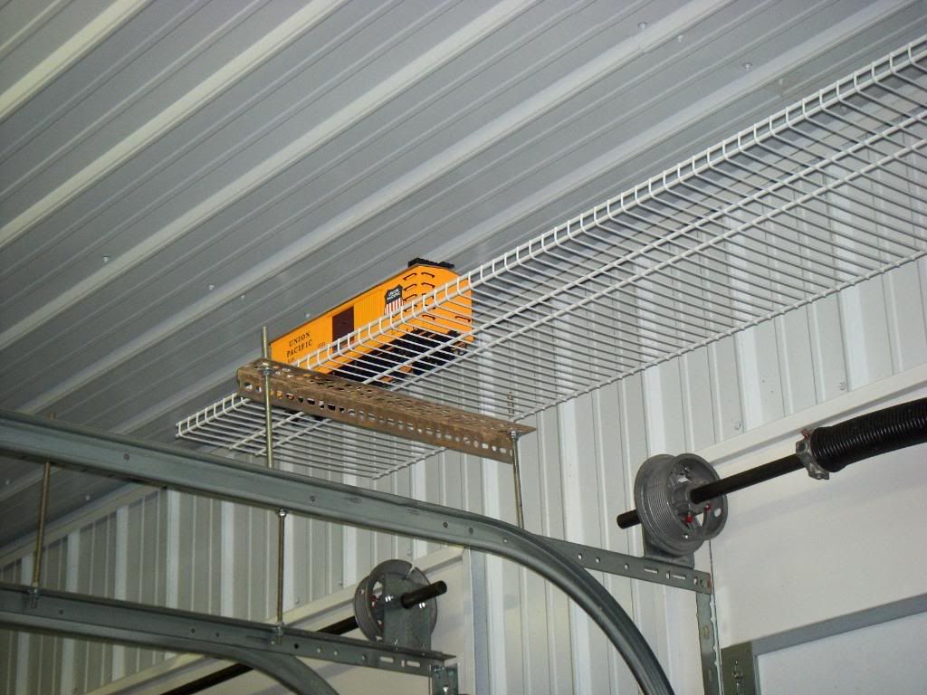

Bought 16" wide Closet Maid shelving at Lowes couple of days ago, going to have to raise shelving about 5 to 6" up to clear garage door when I open, found out that the two parallel runs of round stock you see are the exact guage of G - 45 mm, placed a car on them and rolls great, just to let you know, would work great for display use. I’m going to run two tracks around some day, first have to place and support Closet Maid.

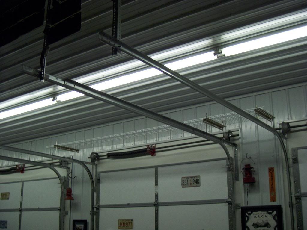

Photo from floor, going to use 10’ radius curves, will have to cut shelving and work out the bends with shelving. Will make some of the supports off of garage door rails and trapeze hangs in this area.

Any ideas appreciated, planning on making up brackets to be supported off of wall on other three walls. thanks as always, Bruce in southern OHIO

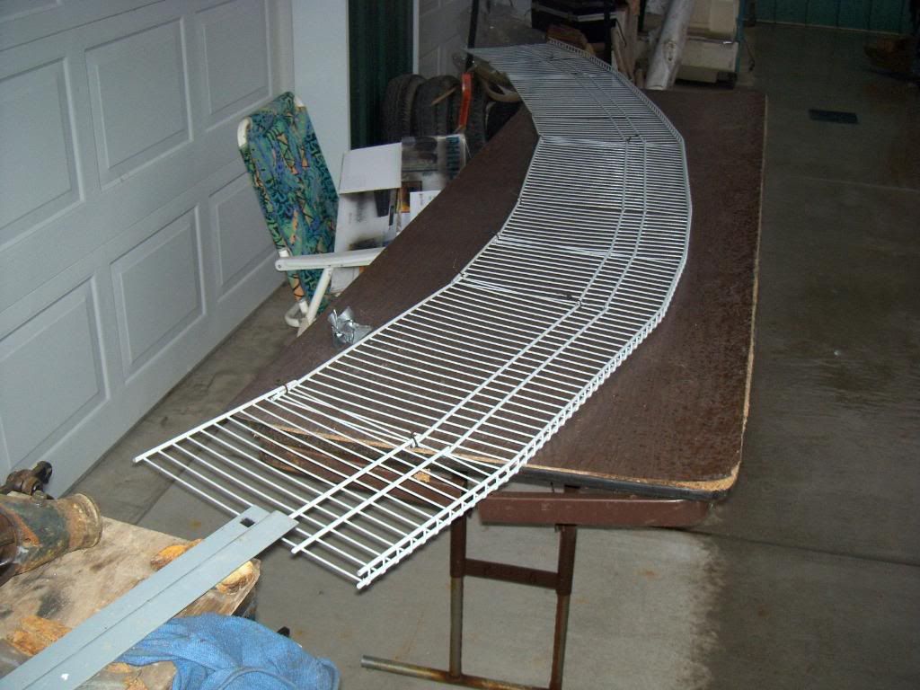

Working on 10’ shelf radius

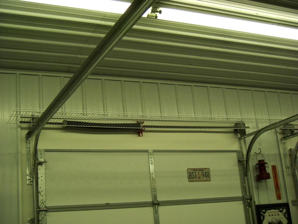

Found that 6 1/2" lift to shelf will clear garage door when opening

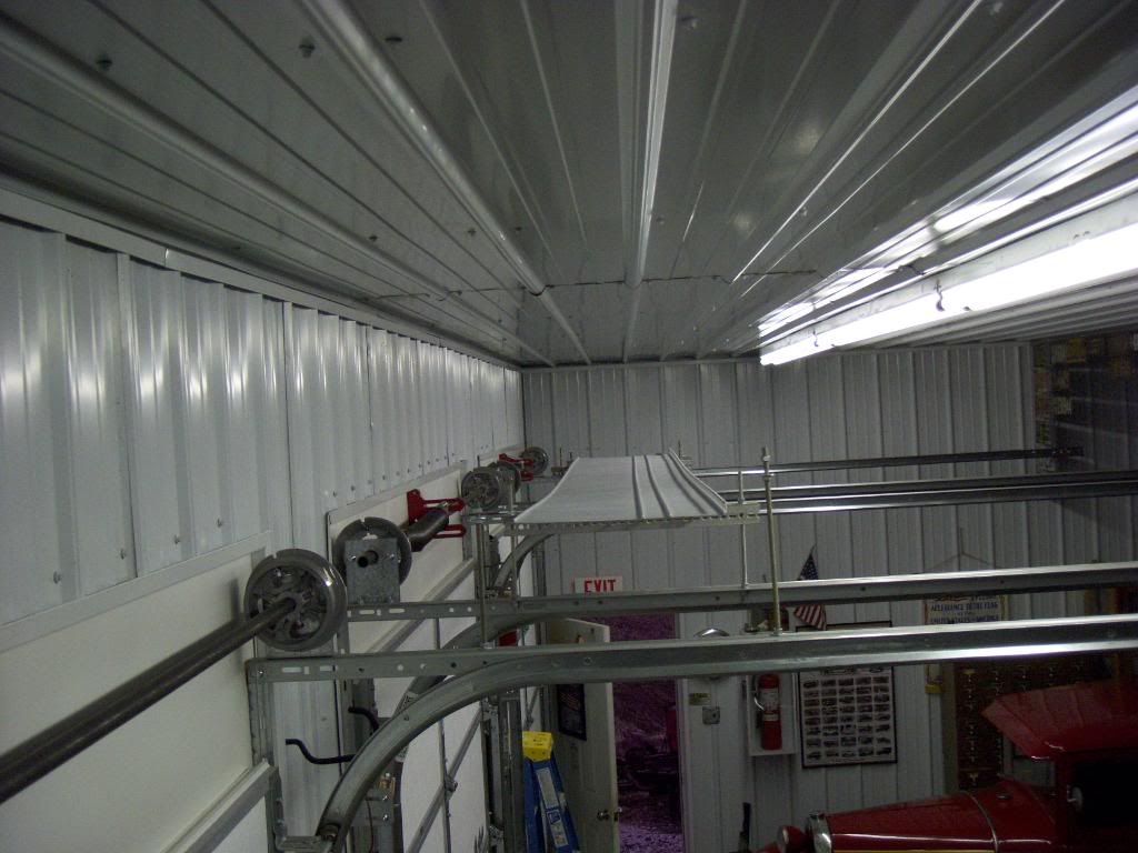

view of shelf
(http://i235.photobucket.com/albums/ee268/bgj1956/HPIM0903.jpg)
view of shelf, will have to add support mid span, just experimenting

Car on shelf
