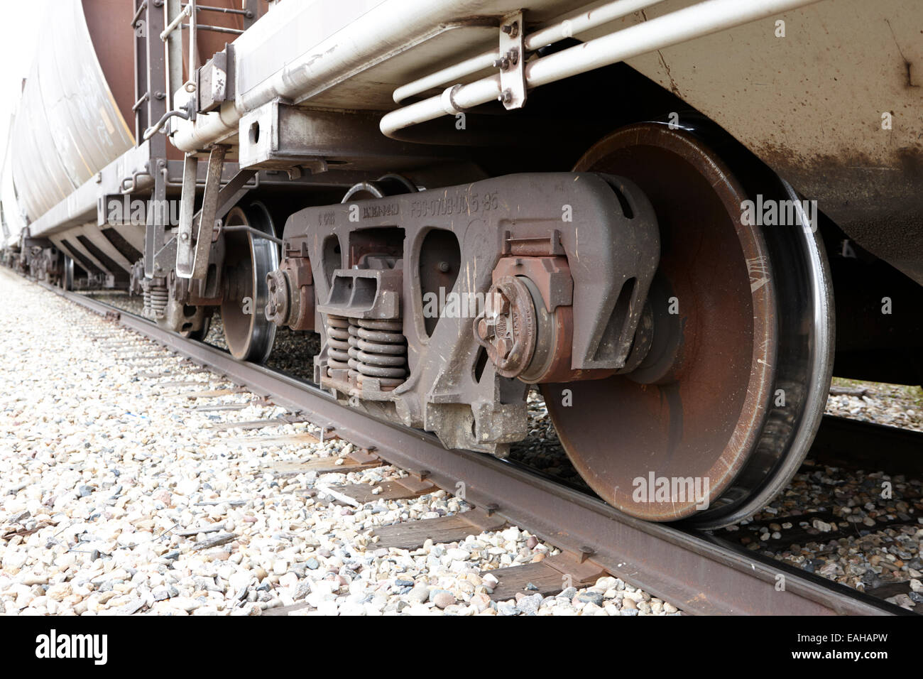

The USA ones look odd to me, with that concave top edge. The Aristo and Kadee look more like the ones I see on the trains that run around here.
Apparently prototype S-2 Barber trucks did have a little dip in the top center, but not as much as the USAT model has in my opinion:
Just to get nit picky, it would seem that Aristo 100 ton hoppers are on 70 ton trucks.
