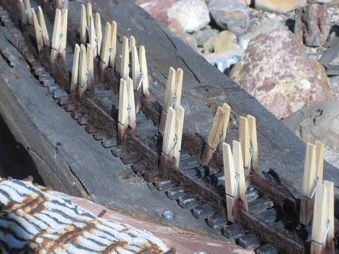

Rust never stops, they say. So when does it begin?
I’ve been busy! But I think this may end up being second best …
The path to the above;
Steel wool and clothes pins soaked with salty vinegar, kinda makes a mess… ya think?
I love the random nature though and variety of color, oh to paint like mom nature!
Before brushing off the stray strands, I sealed it with Fusion clear UV spray paint.
Otherwise rain could wash the rust away.
I covered the rail and painted the ties…
My one dissatisfaction is when I paint the ties, I also cover the rail’s foot … So on the next section I pre-painted the ties and once the paint sets it’s steel woolies time!
3 days sprayed 3-6 times with salty vinegar. Not liking the salt deposits I’m going to try neat vinegar. Hydrogen per Oxide was also suggested as an accelerator… We’ll see.
Welcome to the journey…
John
Nice effects John, but I don’t think I would be using steel wool around my track. The bits you miss cleaning up have a tendency to head for the magnets in loco motors and then they short out(http://largescalecentral.com/externals/tinymce/plugins/emoticons/img/smiley-cool.gif)
John I love the look of the rails after using the steel wool. That’s the way to go. The ties look much better as well. I bet the cashiers look at you funny when you buy all that steel wool lol…
Way back when … I had a black ant problem, their exoskeletons lifted the 0-4-0 wheels up and she stopped. I fixed that by making scotch brite track wipers. One day I ran in the rain and wicked water into the motor yep killed it!
I’m not worried, I have super magnets… on bare wood. I’m also battery powered, so there won’t be track shorts…
I tried baling wire, but it wouldn’t lie flat against the rail …
Still experimenting…
John
