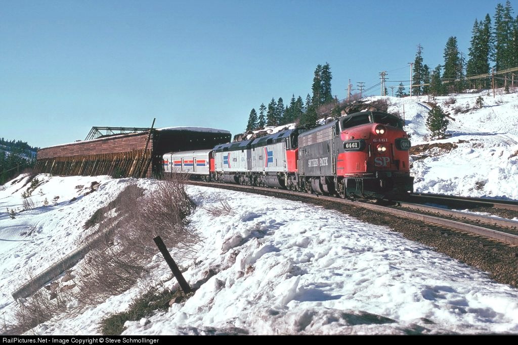

OK, so out of curiosity, I went looking for photos of snow sheds with worn out snow, and found exactly one. Devon, note that where plowed, the snow is lumpy, but otherwise, it is smooth. All photos from RailPictures.net, and copyright is as noted by the photographer.
http://www.railpictures.net/photo/60781/

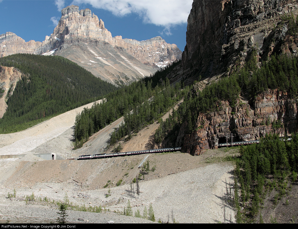

Another thing I noted is that snowsheds only occur where there is a need for them, like this avalanche chute.
http://www.railpictures.net/photo/75177/
Or, this one.
http://www.railpictures.net/photo/302245/
I tried to find photos of snow sheds on Stevens’ Pass, but they are elusive. Perhaps others will have better luck.
Those are great shots Steve and do illustrate well the realization that they are not really built on rock faces but adjacent to them. That was a recent discovery I address in my challenge post. It will require me to move where I was thinking of putting it. The location of the middle picture is about how I see the landscape looking.
Also I agree the snow should be smooth. For this model the plowed stuff will already be gone (I don’t want to model it) so what will be left will be the smooth remnants on top of the shed and part way up the chute. It needs to be smooth but not fluffy and it needs to be dirty. I think Ray’s plan is where I will at least start the experiment. Carved foam covered in white paint and then use the clear acrylic and marble powder. Until this idea came up i never have given any thought to old used up snow. You don’t see it modeled.
