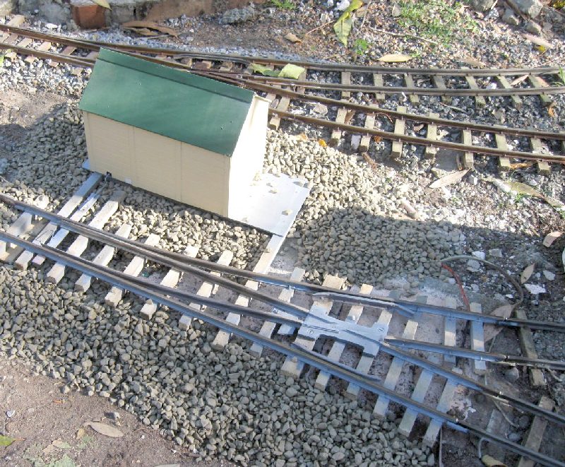

For ‘normal’ turnouts, I make my frogs from 1mm and 2mm thick styrene, laminated to give the correct rail height. I make them very rough shape to start and then file/cut them to match the brass rails when they are installed. The oldest one is 10 years old now. I paint the styrene to help protect from sunlight. It’s best to use black styrene so that when the paint scratches off with rail cleaning, it doesn’t show up as much as white!
(http://www.trainweb.org/SaTR/newLily%20turnout.JPG)
Note that the small ‘guide’ rails at the frog are not necessary. In the real thing they add strength, but we don’t need that. The really critical items are the long wing rails. These hold the wheels out against the main rail, to stop them ‘picking’ the point of the frog.
