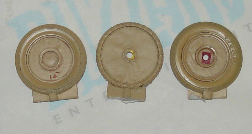

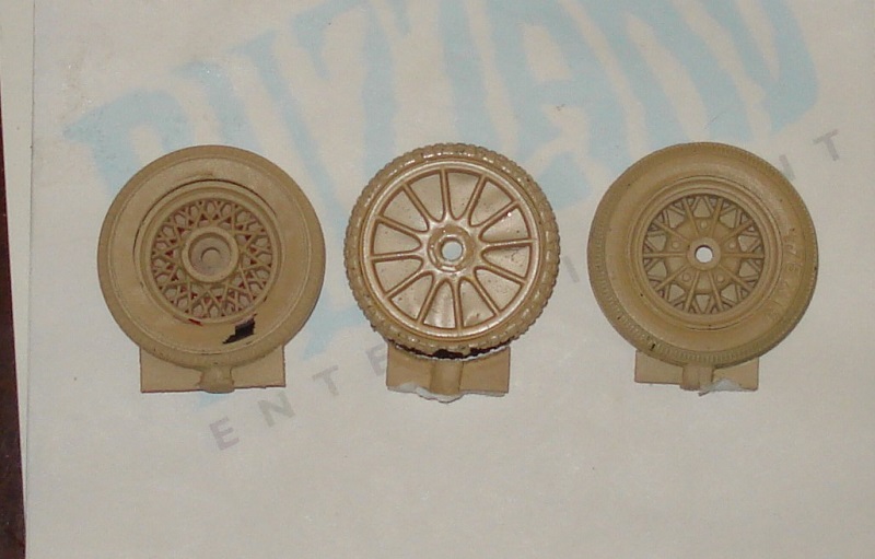

Here are the masters with a vent and support to aid in filling the mold. They are painted with spray enamel to keep the RTV from sticking to them. They are a little beat up from having been molded. Usually have to do repairs before making a new mold.

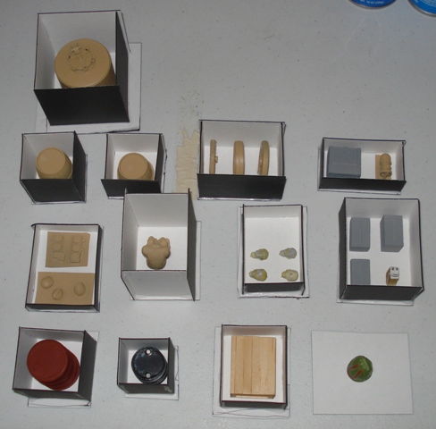

They are glued into the mold box upside down. You can see the tires in the top full row, third from the left.
tire 3

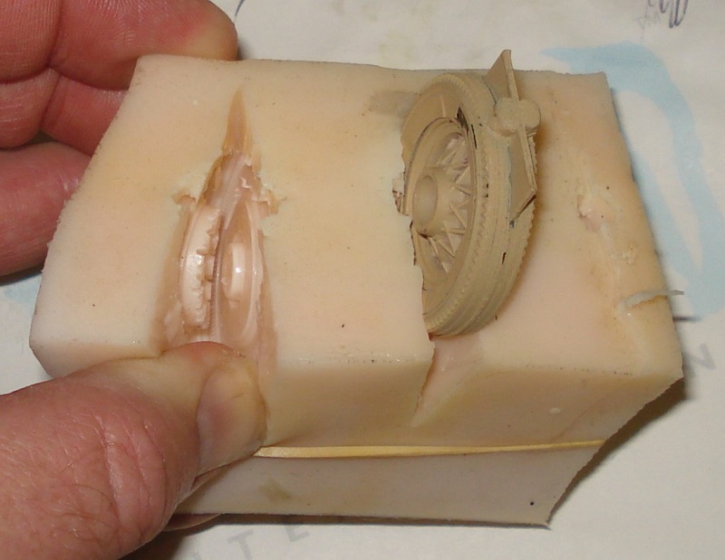

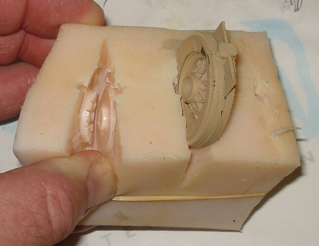

And here is how they are removed from the mold.
This is basically a split mold. The tape is so thin that after casting I found that some of the area between the spokes had no resin layer at all. Those that did have resin flash was easily removed. I have a sack full of these somewhere but cannot find them right now. When I do I will post a pic of the castings.
