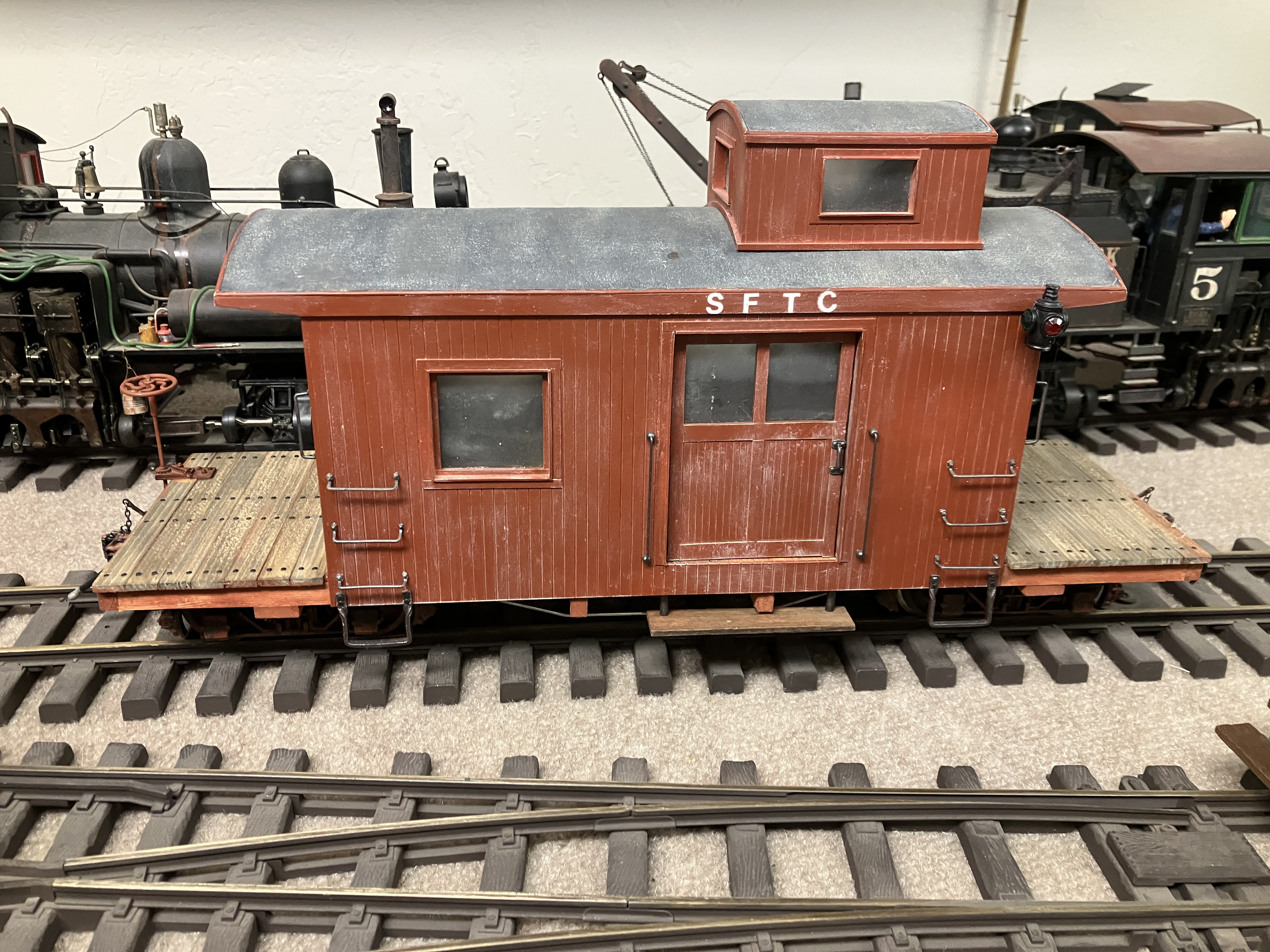

A model of Northwestern Pacific’s Caboose #6007
I built this car a few years back I think with a few modifications it will make an excellent crew car for the fire train.

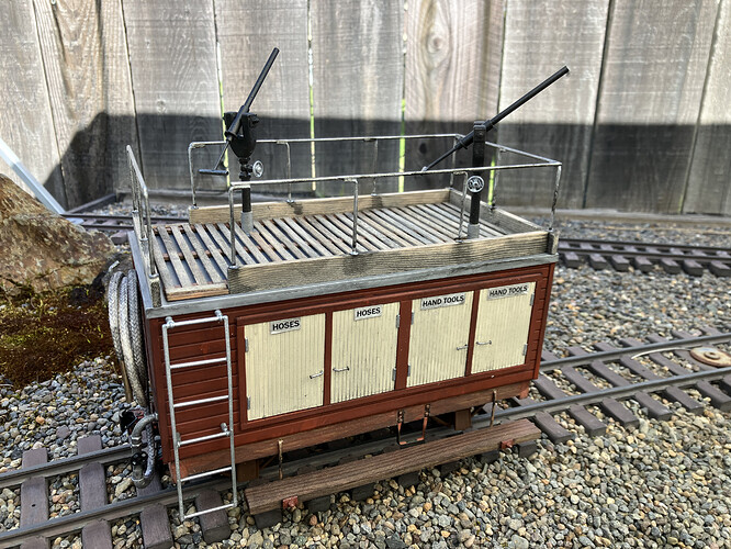

The start of the shell for the water cannon car that goes over the trailing power car.

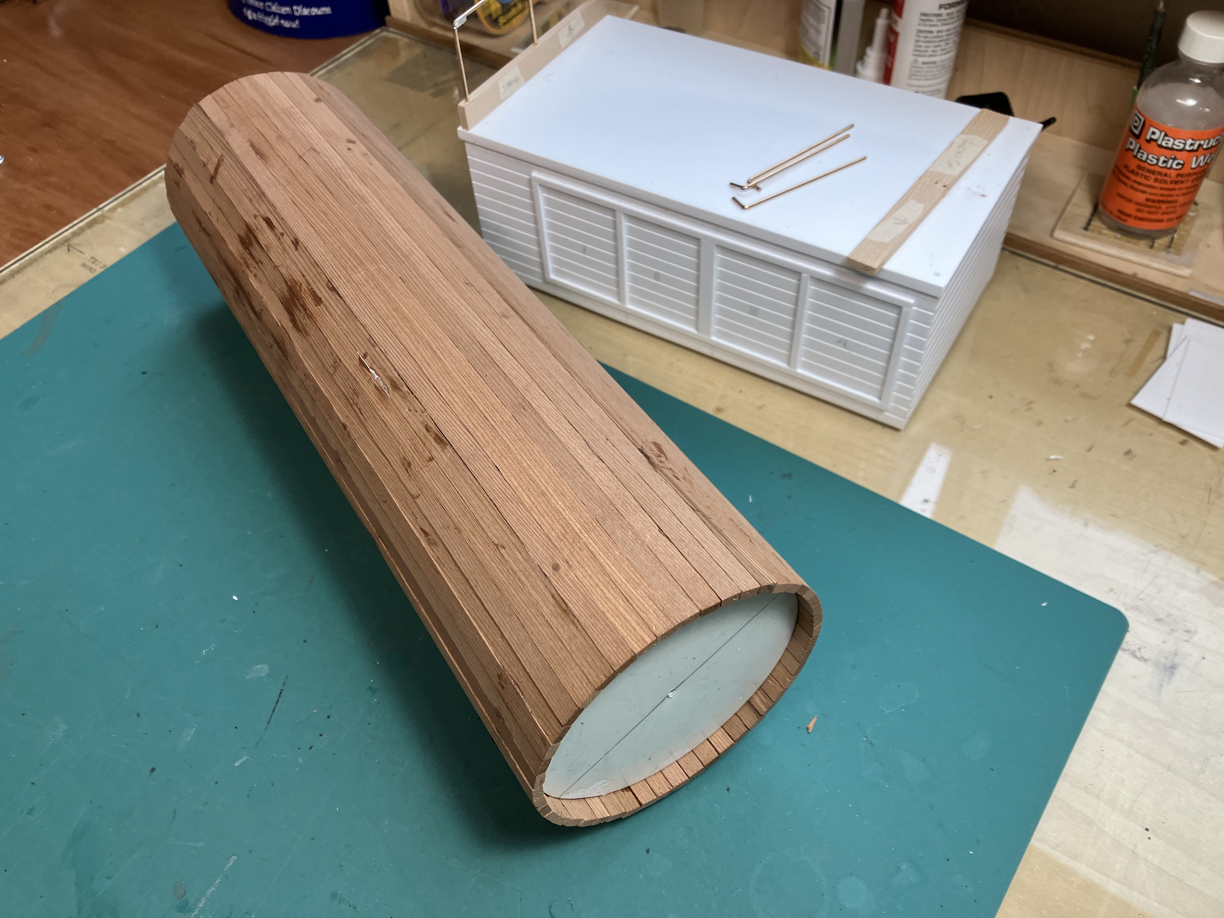

Here the car shell is assembled and we are working on the railings, Also the tank for the water tanker is built from 3 inch PVC pipe and wrapped with Redwood strips that need to be sanded smoth and the ends applied.
Here the railings are all built and test fitted to the car top.
The railings are .063 brazing rod hand fitted and soft soldered. Not fancy but I think they came out pretty good. More to come some time soon, hopefully.
More progress on the water cannon car.
Pictures pretty much tell the story.
Rick I really love the visual impact of the deck, but working off of it I’d more than likely sprain an ankle shuffling around as I worked the water cannon with those gaps.
Dave,
I think your right on both counts.
The gaps are 2 inch in 1:20 but I tried them closer, 1 inch, and visually it may as well been a solid deck from a few feet away.
The water cannon car all finished .

The body of the tank is a piece of 3 inch PVC drain pipe.
The pipe was wrapped with Redwood strips and Styrene ends glued in to hold the end planking.
The tank cleaned up and sanded smooth is fitted to the bunks on the flat car.
