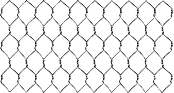

Dang…this IS interesting. But, to me, THIS is chicken wire…
(http://2.bp.blogspot.com/-CXQ3yIUO-n0/US_caQhvivI/AAAAAAAAAj4/kLBSm_OT1_8/s1600/hexmesh.jpg)

But getting back to table top applications, Hardware cloth, (welded squares) is far superior to octagonal chicken wire that will stretch, sag, and let the weed block cloth bulge down in to the large holes inviting some tearing and loss of ballast. Another tip, HC is tough to cut and it may be easier to match the framing to the width of the HC. My TT is 24” inside PT2x6’s on edge w/ PT2x4’s cross wise every 16”. Laying 24” HC was a snap, especially w/a pneumatic stapler. No ledger needed on 2x6, just tipped stapler over and nailed to the face of the 2x6.
