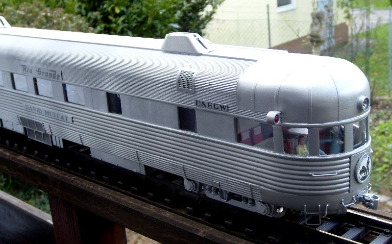

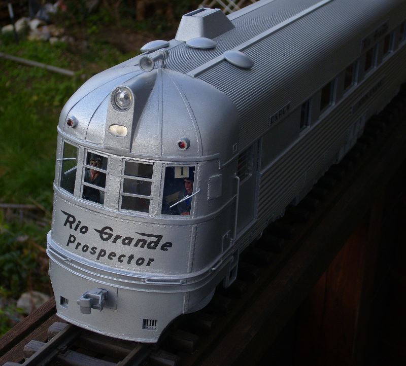

DRG&W M-1 ‘The Prospector’

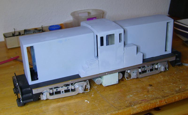

My new project is Rock Island’s #798-799 - Davenport center-cab switchers of 1000hp built in 1950
RI 799 late
I’ll do the early look in all-black painting and with radiator openings in the hoods’ sides.

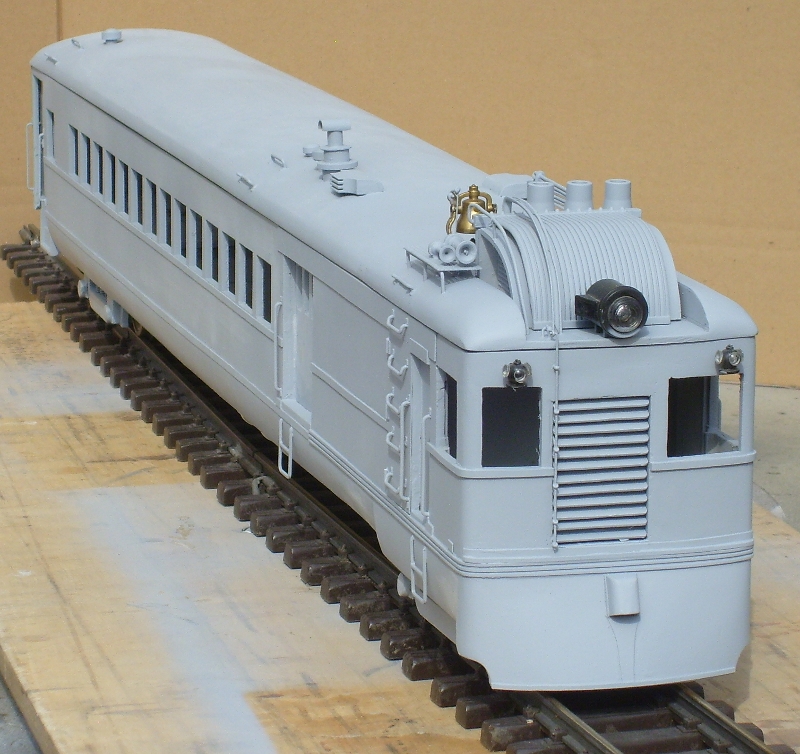

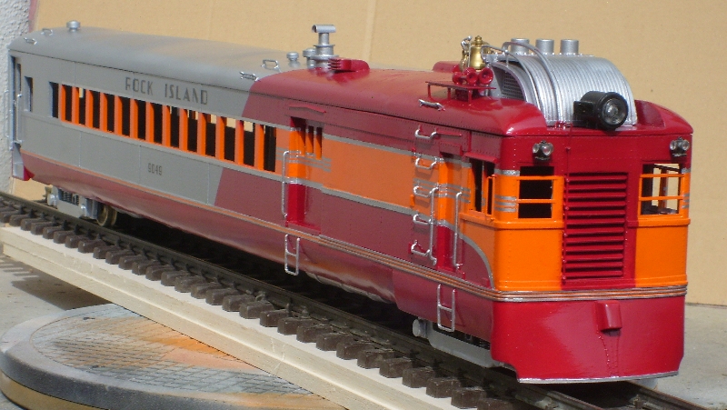

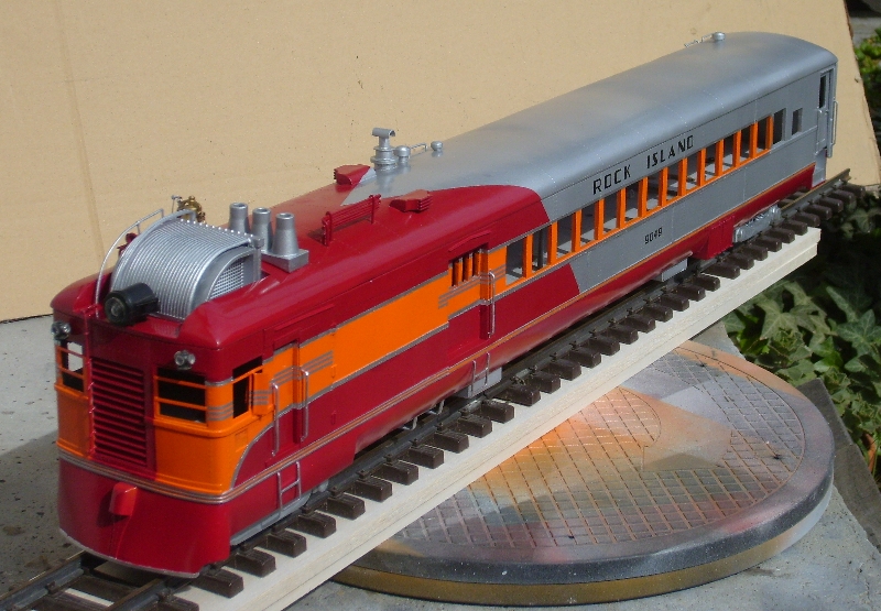

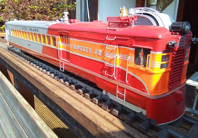

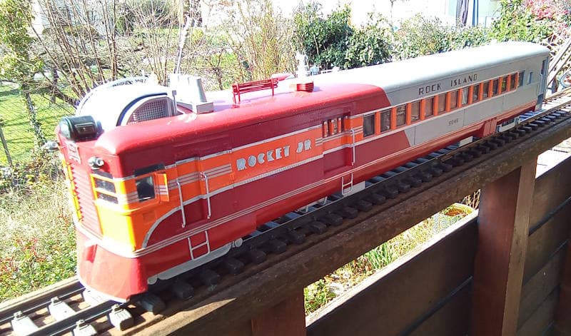

A slightly streamlined doodlebug rebuilt by RI’s shops - motor car #9049 ‘Rocket Jr’
RI 9049
My model is built using an Aristo Doodlebug / Gas-electric
Necessary changes:
  • Lengthened Aristo Doodlebug shell
  • modified number of coach area windows
  • modified cab’s front and side windows
  • GRP skirting
  • Modified Aristo-HW roof
  • Modified Aristo doodlebug front radiator intake
  • USA-Trains NW2 powered front truck
  • USA-Trains NW2-rear truck with shortened wheelbase
And with most of the detailling and lettering done
Regards
Norman

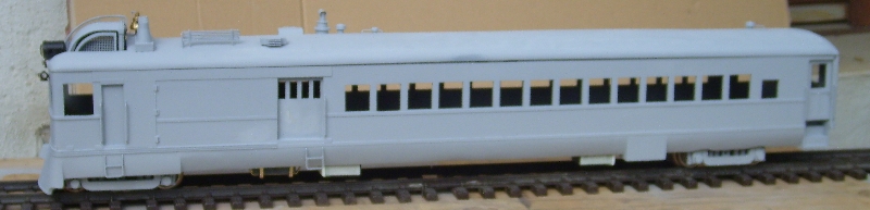

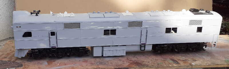

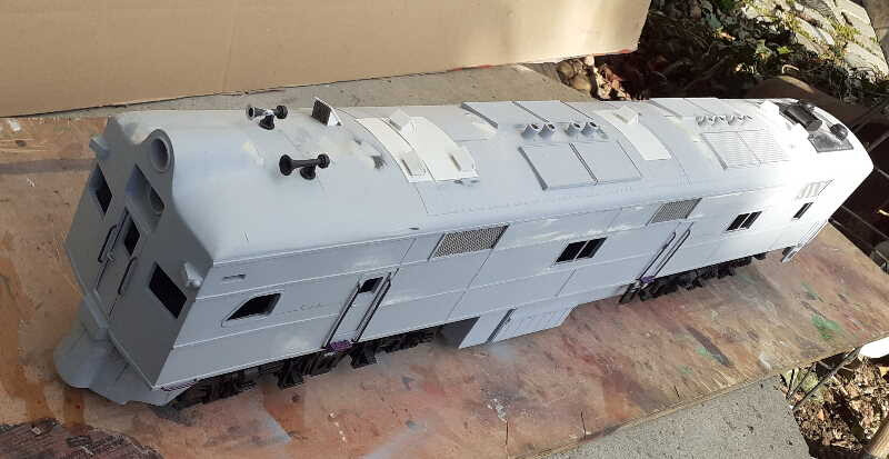

RI AB6 under construction

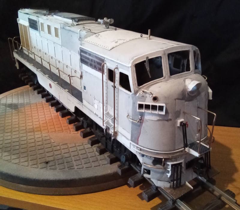

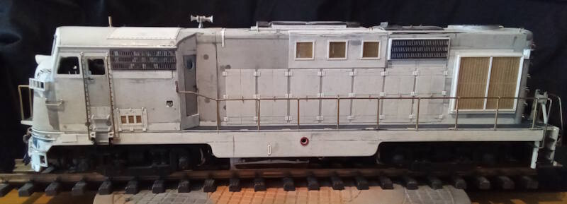

A mix of F7 and and an Alco RS11 by San louis Pototse shop is ready for the paint booth as well

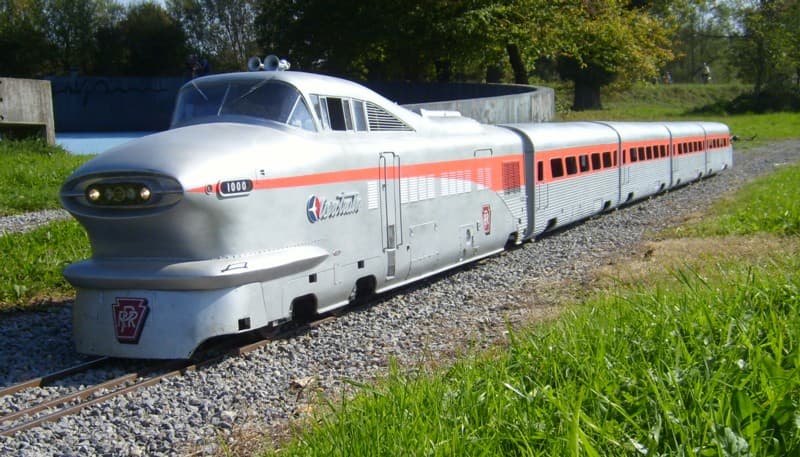

Your Aerotrain is spectacular! Well, all your other stuff is as well, but this is so cool.
