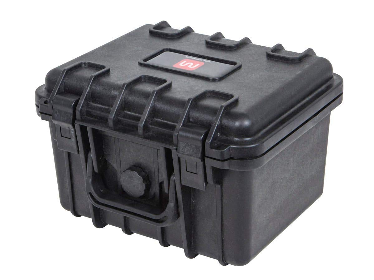

another idea is the sealed boxes for camera equipment, I found one on sale for an obsolete gopro camera and it works fine.
something like this: https://www.amazon.com/Monoprice-Weatherproof-Shockproof-Hard-Case/dp/B00JVA7UGM/ref=pd_sbs_421_7?_encoding=UTF8&pd_rd_i=B00JVA7UGM&pd_rd_r=373a09b2-700b-4757-9ee1-1161dc401a49&pd_rd_w=gJkI3&pd_rd_wg=WGLpz&pf_rd_p=43281256-7633-49c8-b909-7ffd7d8cb21e&pf_rd_r=FS5BA56T6P1MDMCE7Z3V&psc=1&refRID=FS5BA56T6P1MDMCE7Z3V
