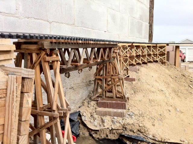

Bent building… last night got 13 bents built… the weekend should be fruitful.

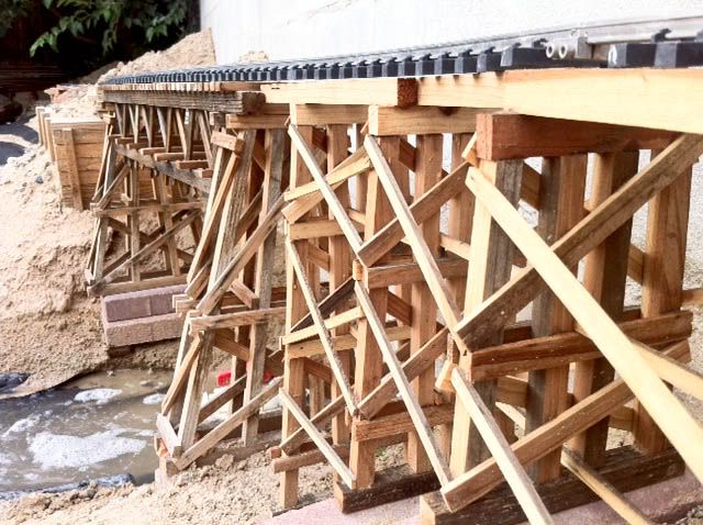

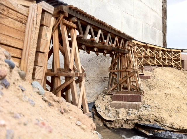

Great day on the pike. Got the bents placed and the trestle finished up to the crossing bridge. Looking SE across the creek and on up the grade.
(http://i1234.photobucket.com/albums/ff403/dave2-8-0/NMNRR-029.jpg)
(http://i1234.photobucket.com/albums/ff403/dave2-8-0/NMNRR-030.jpg)
The Bridge and up the grade.
(http://i1234.photobucket.com/albums/ff403/dave2-8-0/NMNRR-038.jpg)
(http://i1234.photobucket.com/albums/ff403/dave2-8-0/NMNRR-039.jpg)
Looking N and down grade.
(http://i1234.photobucket.com/albums/ff403/dave2-8-0/NMNRR-040.jpg)
(http://i1234.photobucket.com/albums/ff403/dave2-8-0/NMNRR-041.jpg)
And A closer look.
(http://i1234.photobucket.com/albums/ff403/dave2-8-0/NMNRR-037.jpg)
Not to bad of a days work. Tomorrow start on the hillside trestle up hill from the canyon bridge ( 1 x 4 stick right now)
(http://i1234.photobucket.com/albums/ff403/dave2-8-0/NMNRR-031.jpg)
(http://i1234.photobucket.com/albums/ff403/dave2-8-0/NMNRR-032.jpg)
Dave

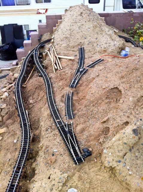

On up the mountain… I had set the right of way, and drove the pilings this spring. I chose to use pilings instead of bents as they have a rougher look and it gives the Mtn. separation from the rest of road. Here is the route from the bridge onto the actual mountain. Looking West, and up grade.

And where the switch will be.

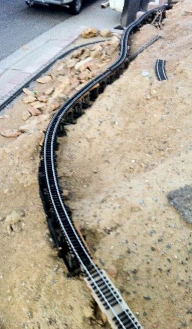

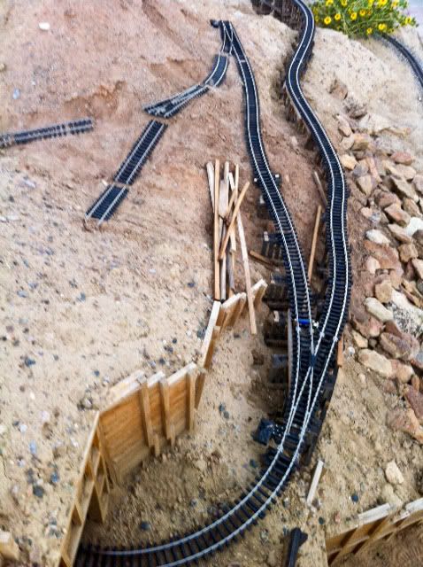

Reset the alignment and the grade to 3.6%, got the stringers glued and pined to the pilings.

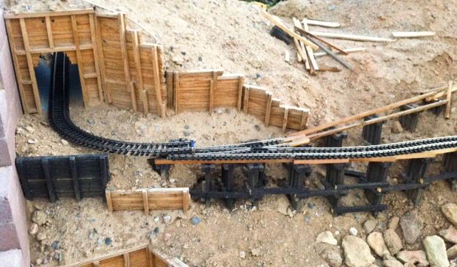

And the switch.
(http://i1234.photobucket.com/albums/ff403/dave2-8-0/NMNRR-054.jpg)
(http://i1234.photobucket.com/albums/ff403/dave2-8-0/NMNRR-060.jpg)

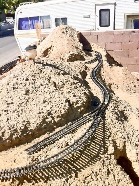

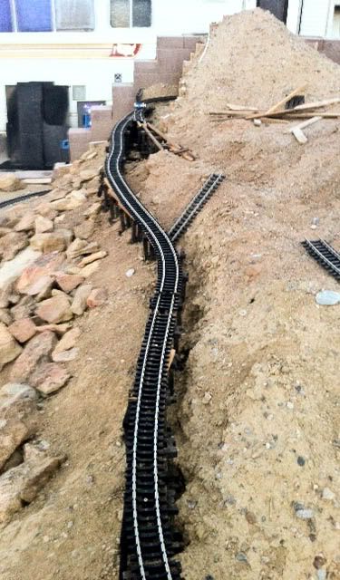

Stole some time and got some track bent… two 8’ lengths of aristo 8’ stainless flex track.
(http://i1234.photobucket.com/albums/ff403/dave2-8-0/NMNRR-068.jpg)
(http://i1234.photobucket.com/albums/ff403/dave2-8-0/NMNRR-067.jpg)
For the area from the switch into the upper tunnel I’m at the limiting factor on the Mtn. div. Right at 24" R. I really don’t want the big stuff up there, and this forces the opps sessions not to try to run K’s into the mining district. It is the mountain district after all.
(http://i1234.photobucket.com/albums/ff403/dave2-8-0/NMNRR-066.jpg)
I’ll still need to tweek some of the curves, but progress is a comming. Dave

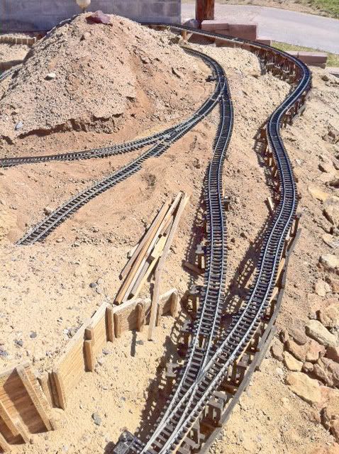

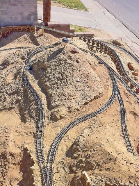

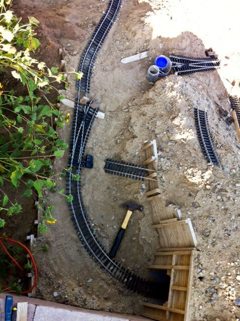

Stole some time yesterday and tonight and got some track bent for the top of the mountain. The mountain will be a loop on top with a connection between the two sides for reversing and switching the mines, and this loop will have the connection track down hill to the main line, the loop will have a tunnel on one end (West). Heres looking from E to W. Up hill on the bottom, mine loop on top.
(http://i1234.photobucket.com/albums/ff403/dave2-8-0/NMNRR-071_zpsf1b553e9.jpg)
Looking to the East from the tunnel and the switch for the connection to the loop.
(http://i1234.photobucket.com/albums/ff403/dave2-8-0/NMNRR-070_zpsd7ab8dbe.jpg)

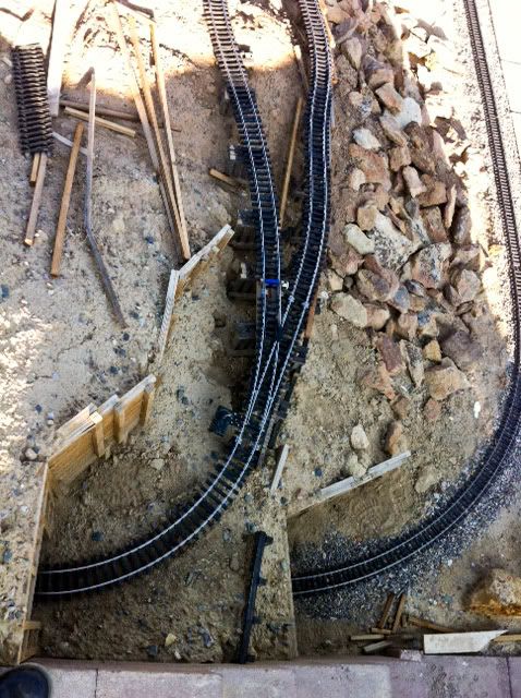

Track and switch looking down on the South portal of mtn line and lower main line.
(http://i1234.photobucket.com/albums/ff403/dave2-8-0/NMNRR-073_zpse5c870c9.jpg)
Looking down on the North portal of the Mtn line. The switch is for the reversing loop. the line will go on around the hill.
(http://i1234.photobucket.com/albums/ff403/dave2-8-0/NMNRR-074_zpsa9c4673f.jpg)
And the view from above the upper tunnel looking E. You can kinda tell where the track will end up.
(http://i1234.photobucket.com/albums/ff403/dave2-8-0/NMNRR-069_zps88fb9634.jpg)

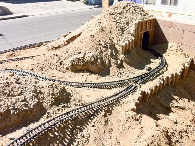

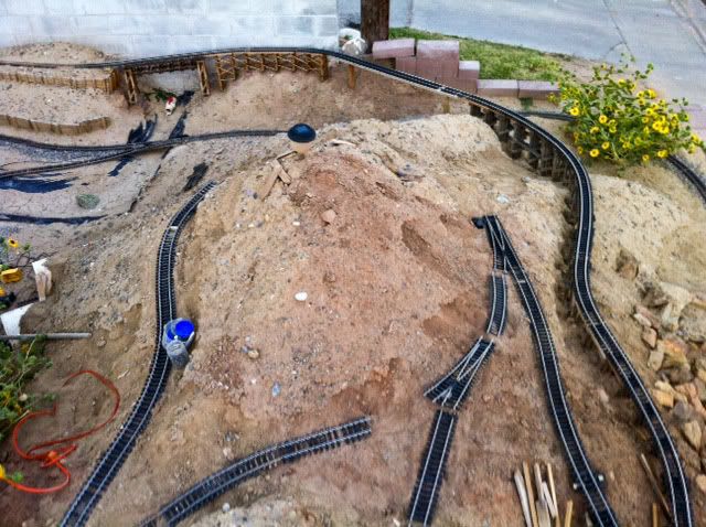

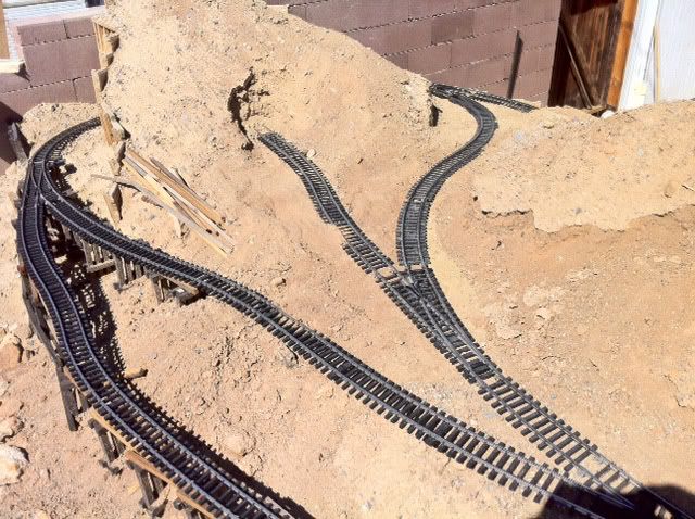

Got some time over the weekend, and got the track on the Mtn, all bent, and aligned, added the new spurs, and got everything to fit up. Looking E. from top of tunnel. South side of Mtn. It actually looks like switch backs.
(http://i1234.photobucket.com/albums/ff403/dave2-8-0/NMNRR-083.jpg)
Looking back to the W.
(http://i1234.photobucket.com/albums/ff403/dave2-8-0/NMNRR-088.jpg)

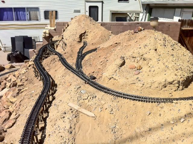

Looking W. At the switch for the reverse crossover. And the spur to the the mine at the top of the W. hill.
(http://i1234.photobucket.com/albums/ff403/dave2-8-0/NMNRR-086.jpg)
Looking Down from W. to E. Shows most all of the top loop, and the reverse crossover.
(http://i1234.photobucket.com/albums/ff403/dave2-8-0/NMNRR-082.jpg)
Looking W. back at the tunnel, and the reverse crossover.
(http://i1234.photobucket.com/albums/ff403/dave2-8-0/NMNRR-091.jpg)
Looking at the E. end, and the new mine siding, The final bend to get around the hill was wayyyy to tight, so I made it wider and added the switch and siding in the cut out space. Yet another opps location.
(http://i1234.photobucket.com/albums/ff403/dave2-8-0/NMNRR-089.jpg)
Floating track, from widening the curve. More timber work to come.
(http://i1234.photobucket.com/albums/ff403/dave2-8-0/NMNRR-090.jpg)

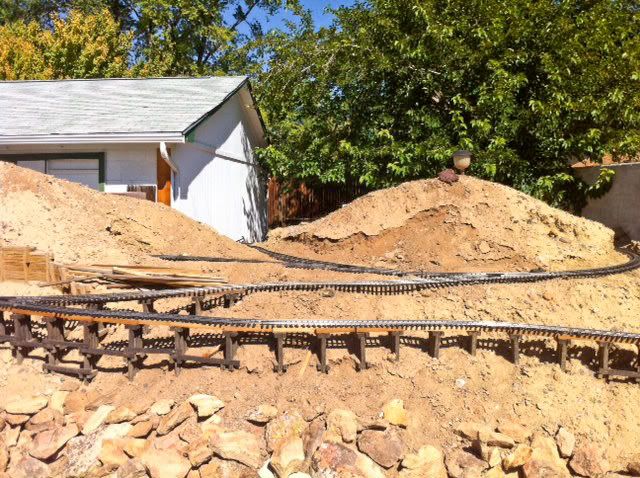

Eye level view from the South Street side.
(http://i1234.photobucket.com/albums/ff403/dave2-8-0/NMNRR-078.jpg)
(http://i1234.photobucket.com/albums/ff403/dave2-8-0/NMNRR-079.jpg)

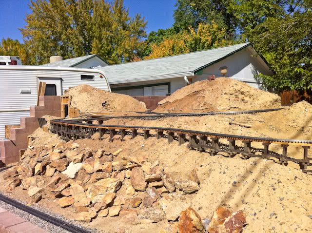

Eye level view from N. Patio side.
(http://i1234.photobucket.com/albums/ff403/dave2-8-0/NMNRR-092.jpg)
Ran my Davenport around the top loop. It stopped 6 times before it made it around once with lots of help from both my 0-5-0 helpers. I had no power feeders at all, only the track rails, from 50’ down the grade, and thru a switches points. After several more helped around the loop tries, and some track cleaning, it ran well around the top and up and down the grade. Whaa Hooo! Next up, Pull the track up, put some pilings in, finnish the grade, run some feeders, Final assemble of the the track, and run some trains…
