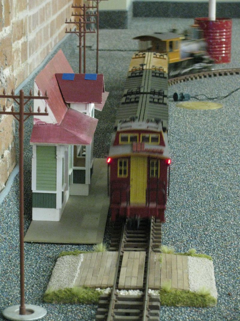

Right now, Yahoo-owned websites such as Yahoo itself, tumbler, and relevant here, flickr photo storage, are loading exceedingly slowly, if at all, or I’d show how I gave my Bachmann bobbers 3 point suspension by changing one axle holder strap.
Steps;
1.) change mounting screws from 2 at ends to 1 in middle.
2.) remove the strap and cut wide enough slots in floor from just outboard of center screw mount to original end slots.
3.) shape floor each side of center screw mount to allow axle holder strap to dip down a bit.
4.) reattach axle holder strap with center screw and leave just loose enough for strap to rock side to side a wee bit.
It makes a difference in tracking.
Just tried Freight shed photos first time and uploaded relevant images.
Look for folder titled Forrest’s fotos
Also include marker lights made from Christmas light LED, styrene tube, and miniature electronics plug. Crude but effective.
Also used some blocks of foam to reduce “echo chamber” sound of empty caboose body.
Thanks again, Forrest. I really appreciate the input.
Here are the photos of your modified caboose…

Aha! Found a 2011 photo at our then brand new model RR club where the marker lights are lit.
Tube over LED has an opening aft, outboard, and forward. LED were those with the inverted cone end with inverted cone lined with Bare Metal Foil, or Testors version of, chrome foil to reflect light out and down even more than inverted cone already does.
And I successfully got photo in here, even shrunk a bit, from the Freight Shed folder, first time ever tried, yay me! (http://largescalecentral.com/externals/tinymce/plugins/emoticons/img/smiley-laughing.gif)
Oh, and green wires pirated from Christmas lights stripped of LED are used for feeders to rather large Bachmann set track oval.
Was later said to me that use of standard outlet plugs could be an issue for the uninformed who dared to tinker with my trains when I wasn’t around. Oh. (http://largescalecentral.com/externals/tinymce/plugins/emoticons/img/smiley-embarassed.gif)My brain was thinking that I have this wire and have no extra money at that time, use whatcha got and it will definitely carry enough current.
