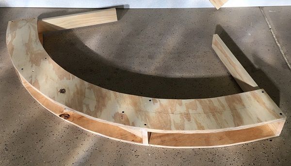

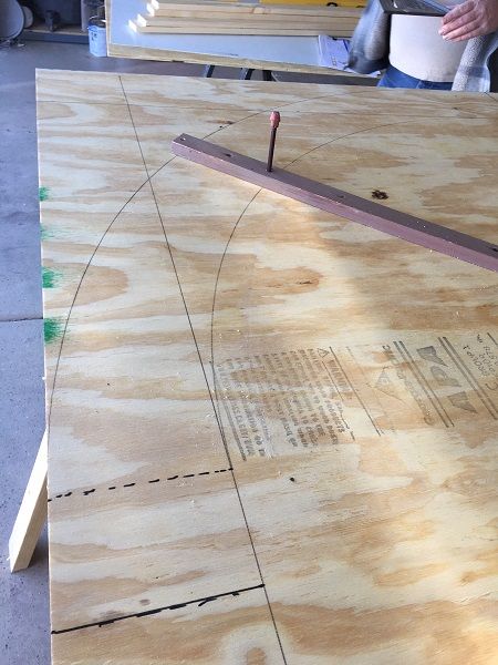

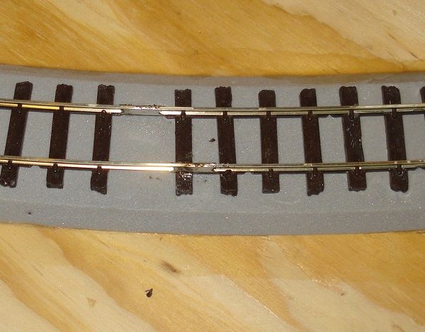

After Two years of using the HO style corners the group decided we needed something easier to carry and store. We came up with this design for minimal corners.
They are each 90degrees and just wide enough for the ROW. Each corner has a 4" straight lead-in on the ends and then the curve.
I did the cutting. Good times. Got some aggression out.
Wood work complete. Very strong and they weigh almost nothing.

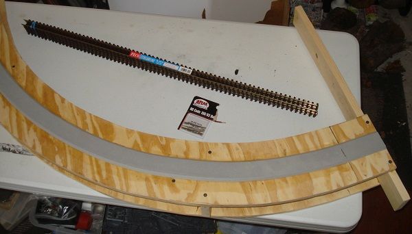

Road bed goes down. We are using a different foam from the neoprene sold by Woodland Scenics. This stuff is similar to what is used for embedding tools in a tool box.

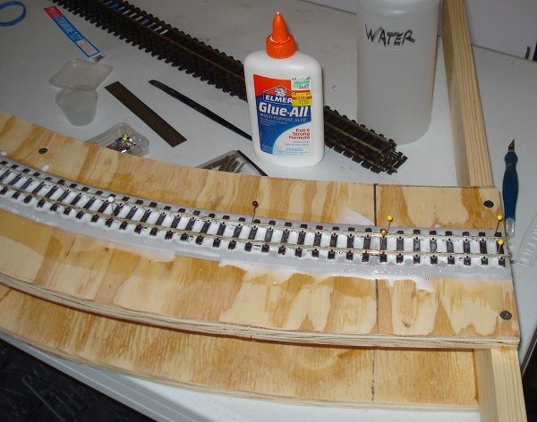

Track gets glued down. We no longer do jumper tracks. Modules are held together by two super-strong magnets in each end and the track butts together at each joint. Sometimes we don’t even use joiners.

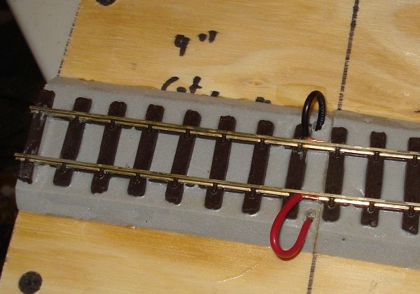

Regardless of straight or curved modules all mid track joints are soldered.
Jumper wires are soldered on each end.
First run will be later this month. Fascia boards, paint and ballast will be added this summer.

Corners wired and fitted.
