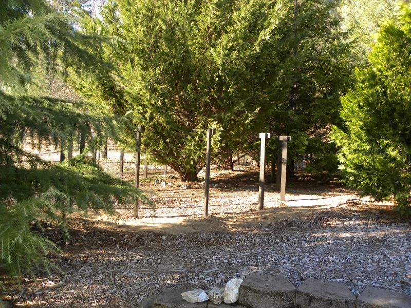

      Looking west from the Hyampom Yards, foreground on right, the line will continue along the fence then turn and go along the west property fence.  The PVC loop on the ground is the line returning on itself creating a 220 foot loop for roundy round running. Where the PVC meets the new support post's is where I want to install the spring switch that I asked about elsewhere.  From this side the switch will be out of reach and the lift bridge location is out of site to the left, a long walk around while the train is closing on the switch. And it's to darn low for crawling under.

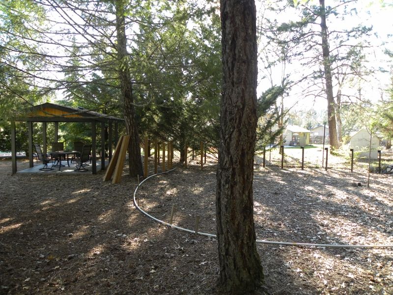

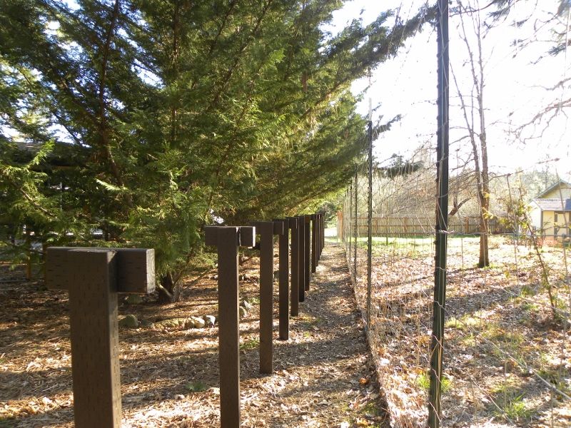

      Along the west fence, we left a 30 inch wide walk way between fence and tables for access, this will not be a regular walk along or viewing area.  What is hard to see in the pictures is that the railroad is on a 2 percent down grade from the time it leaves the bench near the TT in the first picture till it gets to the far end of the posts in this picture.

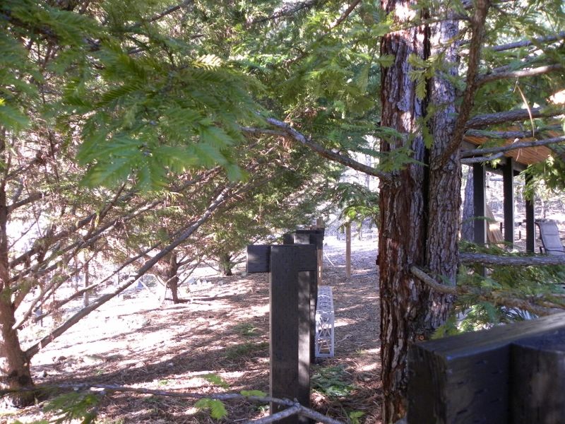

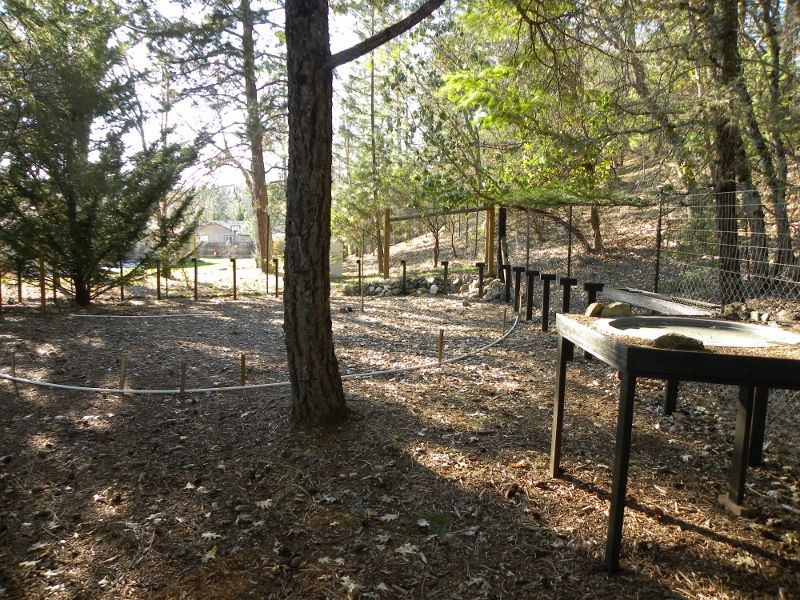

      The return loop.  The track will be level through the this area and start back up on the 2 percent after leaving the loop.  Due to room issues the loop is only an 8 ft 6 in radius but shouldn't be any trouble.  Here you can also see the reason for the grade, without it the track would have been about 72 inches off the ground, as it is now it's only about 54

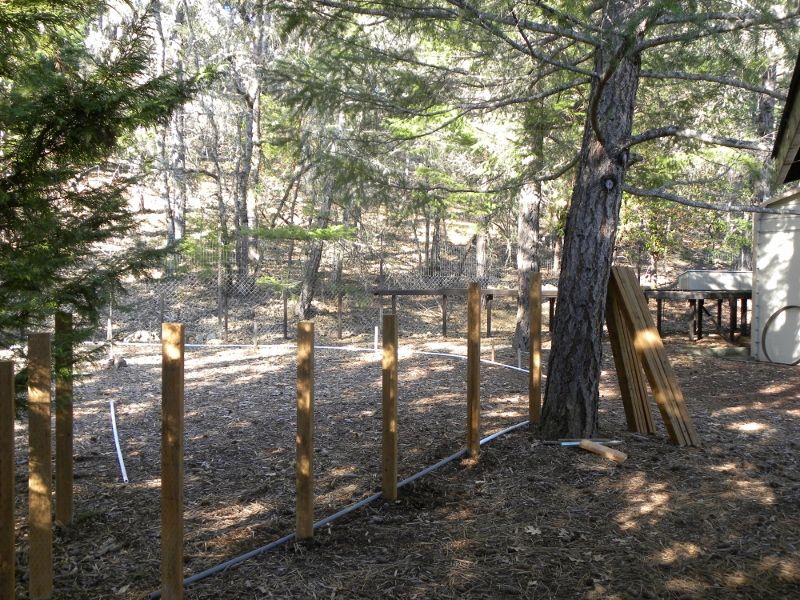

      After leaving the loop it's back upgrade through the trees.  You can see the bridge sitting on the ground to be installed here.  No real reason for the bridge other than I have it and might as well use it.
