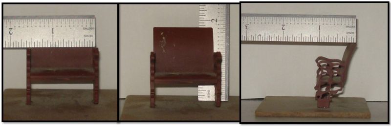

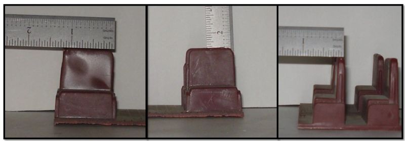

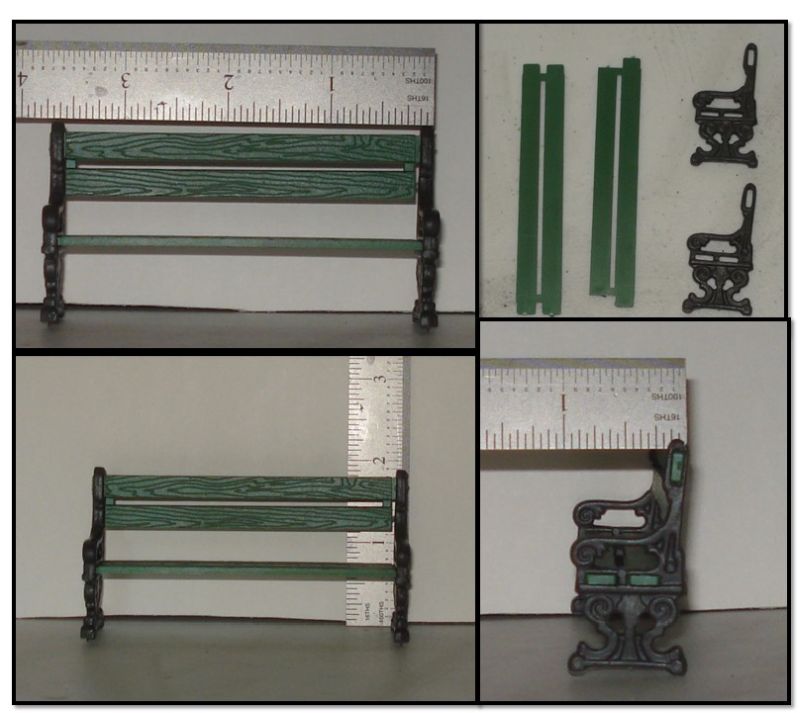

    • July 1, 2018 11:51 AM EDT
      • Holiday Inn Express, School of train repair
      • Posts
        739
      • Thanks
        762
      • Thanked
        521
      David
      Measurements on both of the above mentioned seat options plus the "depot bench" from Just Plain Folks.
      Seats from the Bachmann J&S passenger cars:
      Seats from the Accucraft J&S passenger car.
      Depot bench from JPF. These could be easily cut for length and height as well.
      If you can find them the seats from the Aristo-craft Sierra coach they might work.
      Sorry no measurements on these.
      My last suggestion is that you make some simple benches out of bass wood. Several of the LSC members have done that. Perhaps one of them will post some pics of their work here.
